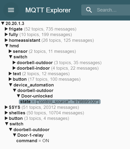

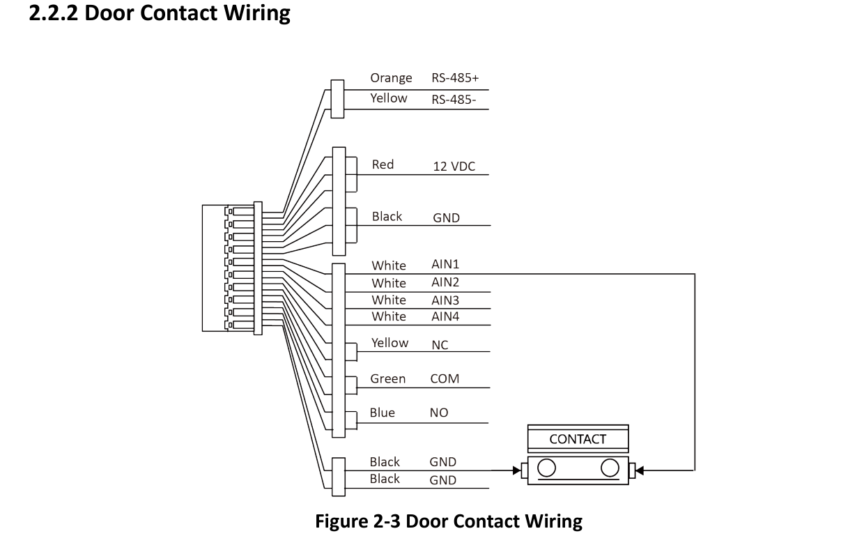

I am installing a DS-KV6113, and I would like to use the door contact for my gate cover as a true feedback of the OUT relay ( GND and AIN1 as per Hikvision install manual)), but it seems that I cannot find it on MQTT topics, can you please give me some info about this? The topic hmd/device_automation/doorbell-outdoor/Door-unlocked/state send a payload when I trigger the gate opening instead of the door contact.
Did someone have been able to use it? Shall I open a new topic about this?
i dont think its possible to provide an real state of the pins
Pity, thank you for the quick reply anyway.

But I don’t know how to call directly the AI1 value… Am I wasting my time?
Does it matter if you retrieve all inputs? I don’t see the state anyway?
You say that Hikvision gives the possibility to connect a contact/sensor (like for the door relay), explain in the documentation how to wire it, and then it’s not possible to use it somehow?
If you can’t read the value of the AIN from the addon I was thinking to do a template in the cover configuration somehow to confirm my gate is closed after xx minutes from activation.
ok, if you can find a solution , you can share it here
