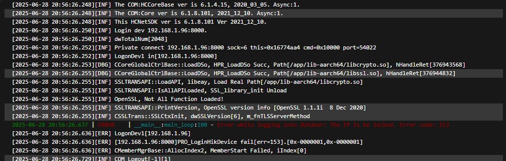

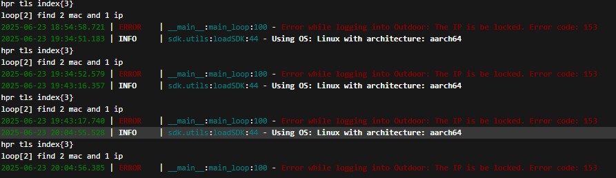

Hello. I can’t seem to solve a simple problem with blocking the IP intercom. When I start the docker container, I get an error message. I’ve restarted the intercom, docker, and the system, and waited for over an hour, changing the login and password that I’m 100% sure of, but nothing seems to work. What do you think the problem is?
Maybe reboot the device

Fabio, sorry for repeating myself, but I still couldn’t solve the problem of communication with the DS-KV6133 panel. Here’s what the logs say when DEBUG is enabled.
Addon works in a separate container.
Please help me, what am I doing wrong?
Somehow the Hikvision is blocking the access, try reboot the device first, try with another password, maybe it’s a character issue
Unfortunately, I have already done all this and more than once. Rebooted, changed the password to a simpler one without symbols…
Thank you, I will continue to look into the problem
