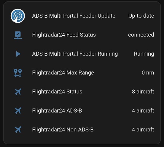

Well and truly impressed by this! I’m up and running after just a couple of hours work! Thank you all involved! :heart_eyes:
I wish I could see my range though, it seems the sensor needs a unique ID…
