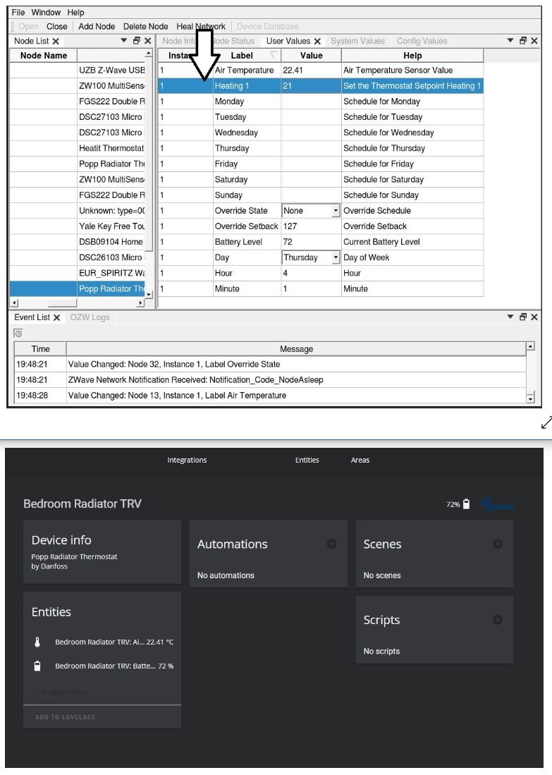

The only thing I am struggling with is all my Danfoss TRV`s arent showing the heat set point inside Home assitant but are viewable on the Openzwave app.
Am i missing something to force it to automatically add?
Thanks in advance
Did you report it on the github issue tracker?
In the meantime you can setup a MQTT climate device in your configuration to get by for now:

Any pointers you can give me on how to setup HVAC with openZwave please?

I’ve done something similar for my cover you can see this post you’ll need something like MQTT Explorer to get the ValueIDKey and such.
If you need help adapting my post feel free to open a new thread and tag me :slight_smile:
