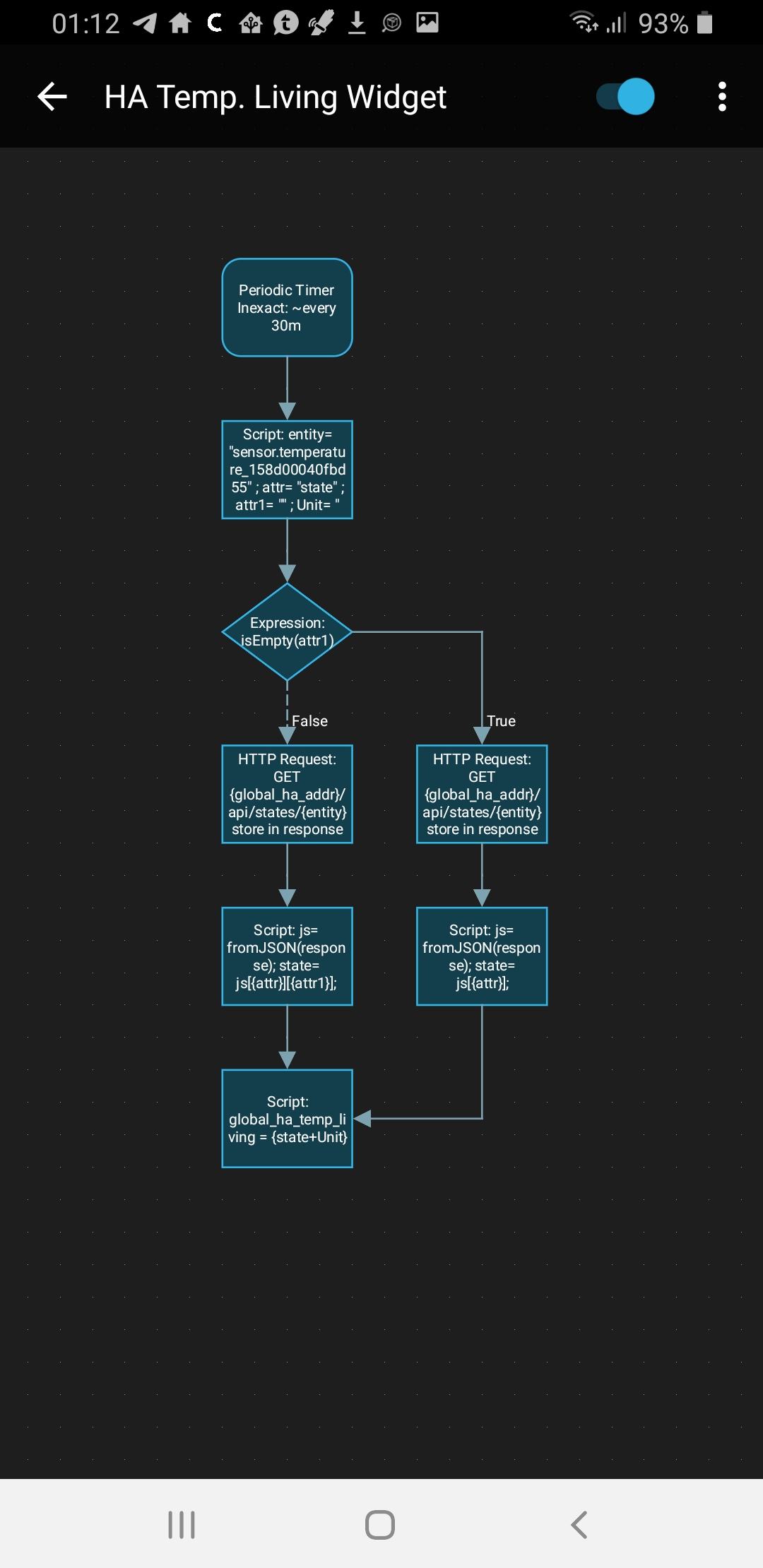

This is one of the example flows group. With this flow we retrieve studio temperature from Home assistant every 30 minutes (see inside first block where there is the timer):
In the second block we have to enter the entity wich we want to retrieve the status, the attibute three (if the attribute that we are searching is not nested we have to use only “attr” leaving attr1 empty) and the unit of the data:

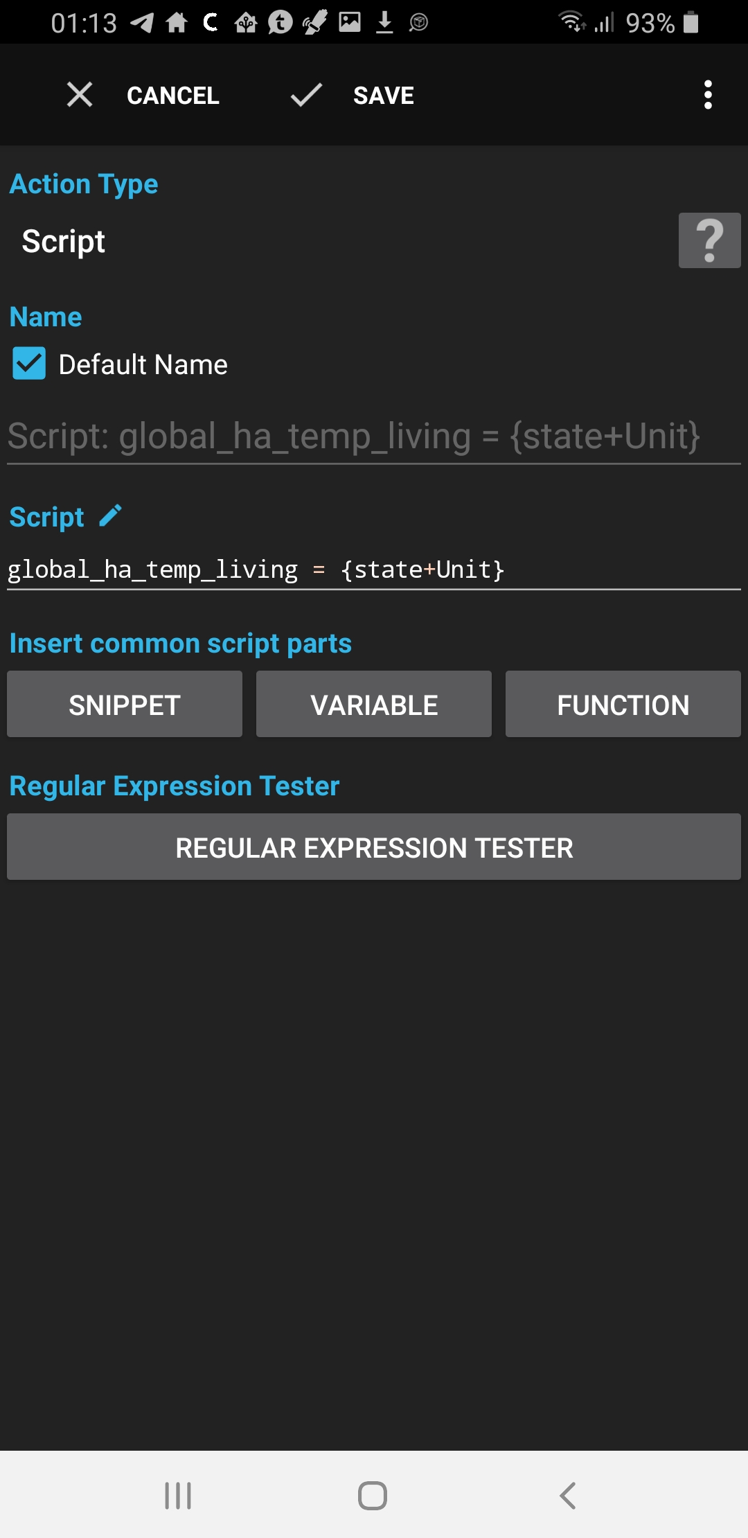

Last block that we have to edit is the last one: in this block we have to create a global variable (with an appropriate name) where we store retrieved data (studio temp. in this case). This global variable is then used in the widget. Leave untouched part = {state+Unit}
After that come back to the flow view, tap on the 3 points at top right and choose “Execute”. You should see flow to run.

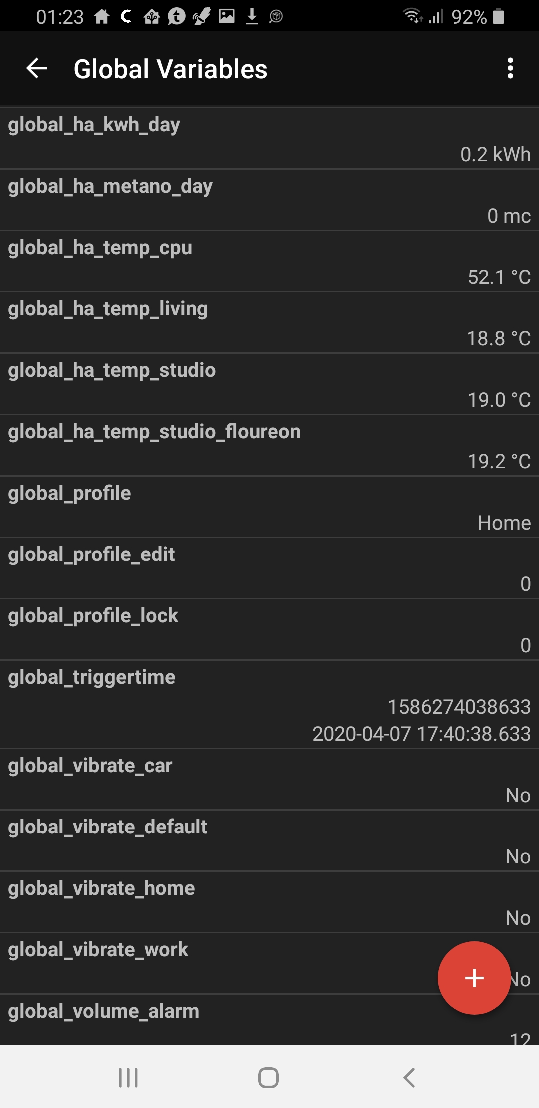

To check if data are correctly retrieved (and related global variables created) come back to Automagic home page, swipe left side, tap “global variables”: you should see all global variables that you created with related readings:
