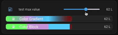

I recently created something similar for my custom card. so let me improve your template. I modified the function so that the background gradient width is in the range of the maximum entity current value, instead of the entire 100% card width. I created two versions, one with a color gradient and the other with color blocks. Maybe someone prefers this style more.

color blocks

bars in entities card
2025-07-01 23.44.05
