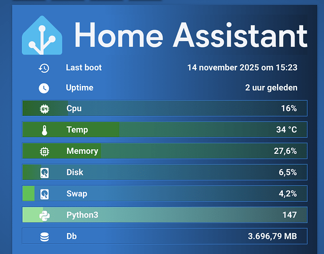

Full card
type: entities
card_mod:
  style:
    hui-sensor-entity-row:
        hui-generic-entity-row {
          height: 25px;
          padding: 0px 16px;
          border: 1px groove var(--primary-color);
      {% set light = is_state('binary_sensor.donker_thema','off') %}
      {% set kleur = 'var(--ha-color)' if light else 'var(--primary-color)' %}
      ha-card {
        box-shadow: var(--box-shadow);
        background: linear-gradient(90deg, {{kleur}} 30%,var(--card-background-color) 100%);
        color: white;
        --icon-primary-color: white;
        --mdc-icon-size: 20px;
        font-weight: bold;
entities:
  - type: custom:hui-element
    card_type: vertical-stack # required because hui-element does not support visibility
    cards:
      - visibility:
          - condition: state
            entity: binary_sensor.donker_thema
            state: 'on'
        image: /local/home-assistant/home-assistant-wordmark-color-on-dark.png
        <<: &picture
          type: picture
          entity: device_tracker.ha_main
          card_mod:
            style: |
              ha-card {
          tap_action:
            action: more-info
          hold_action:
            action: navigate
            navigation_path: /config/system
      - visibility:
          - condition: state
            state: 'off'
        image: /local/home-assistant/home-assistant-wordmark-monochrome-on-dark.png
        <<: *picture
  - entity: sensor.last_boot
    format: datetime
    <<: &no_border
      card_mod:
        style: |
            border: none !important;
  - entity: sensor.uptime
    <<: *no_border
  - entity: sensor.processor_use
    card_mod: &perc
      style: |
          background:
            {% set perc = states(config.entity)|float(0) %}
            {% if perc >= 59 %} {% set bar = '255,0,0' %}
            {% elif perc >= 44 %} {% set bar = '128,0,0' %}
            {% elif perc >= 24 %} {% set bar = '255,165,0' %}
            {% elif perc >= 9 %} {% set bar = '0,100,0' %}
            {% else %} {% set bar = '0,128,0' %}
            {% endif %}
            linear-gradient(to right, rgb({{bar}},0.9) 0%, rgb({{bar}},0.6) {{perc}}%,
                                      rgb({{bar}},0.3){{perc}}%, rgb({{bar}},0.1) 100%);

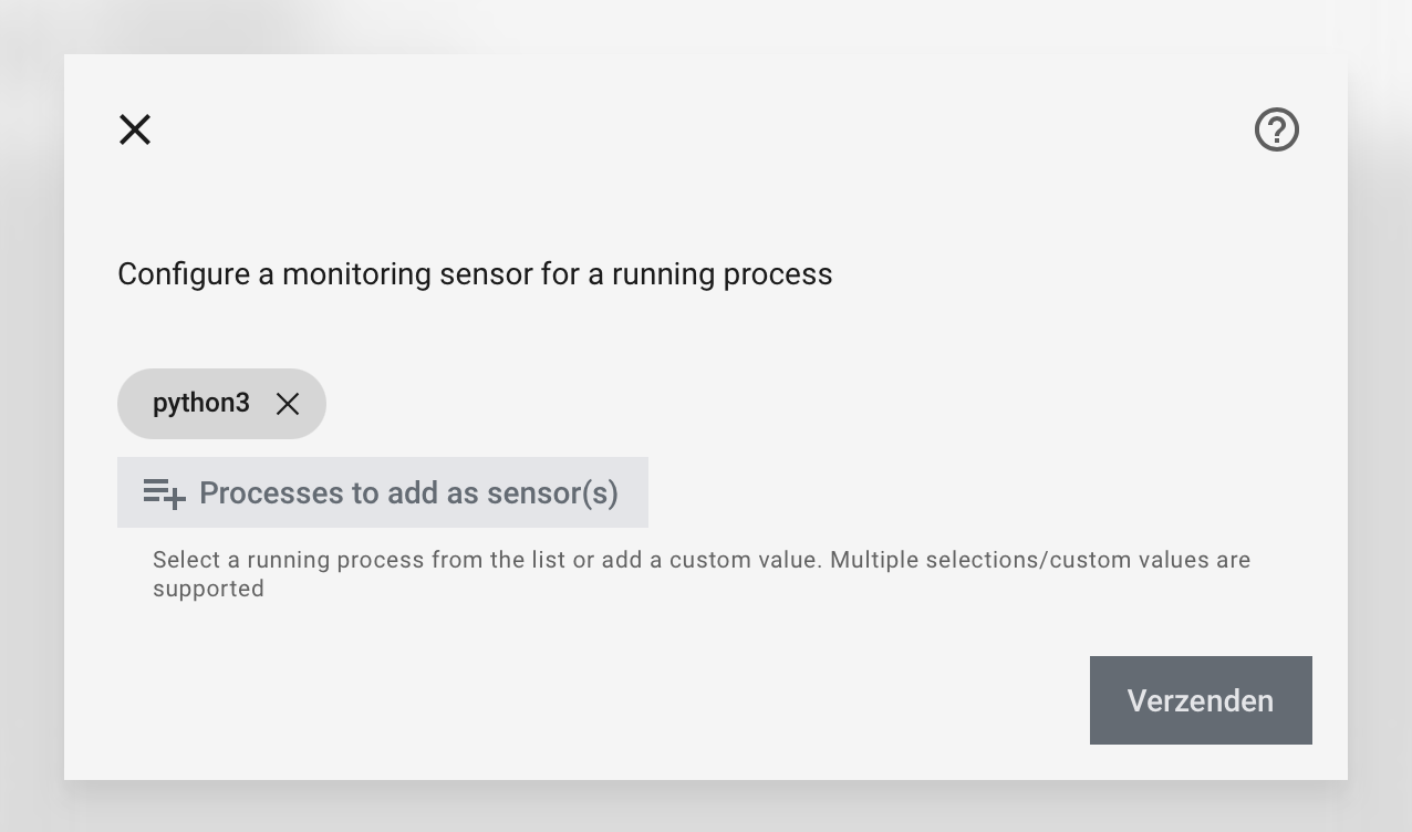

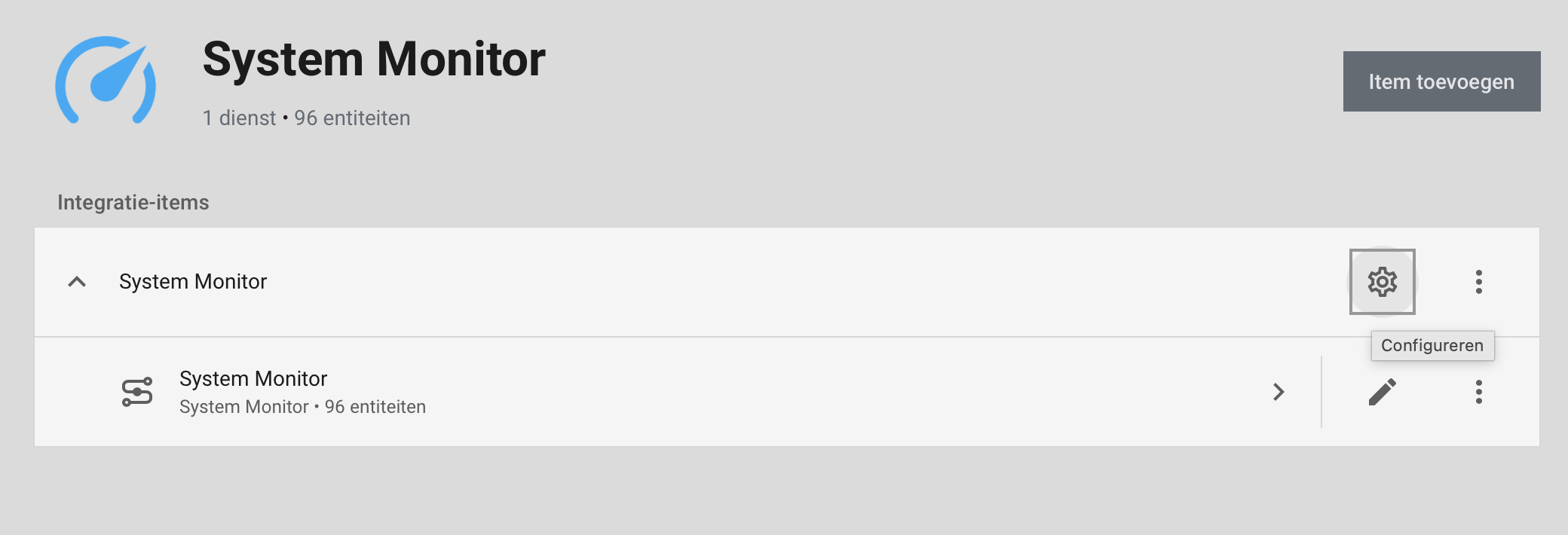

I know this is a little old but I have two questions as I am trying to replicate this:
Where did you get: sensor.system_monitor_open_file_descriptors_python3?
Also, where can I find the png file you used.
Thanks very much.
The entity is made after instruction System Monitor in a special setting, you can look it up there.
click the cogwheel
and next select a monitoring sensor you want to install
also check this instruction set About open file (descriptor) limits on Home Assistant OS · home-assistant/operating-system · Discussion #4166 · GitHub

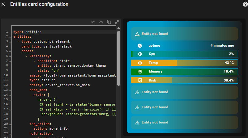

Hi Marius. I’m getting a lot closer. I am however having an issue with the image entry.
I haven’t change the code for the image part. Not sure what I’ve got wrong.
Thanks. Getting a lot closer.
if its a fronted error, there should be something in the Inspector pane, did you check?
also be sure to change the calculations/thresholds for the temps. We use C here, and you’re way up in red there :wink:
the others errors are missing entities, so just adjust the card for those

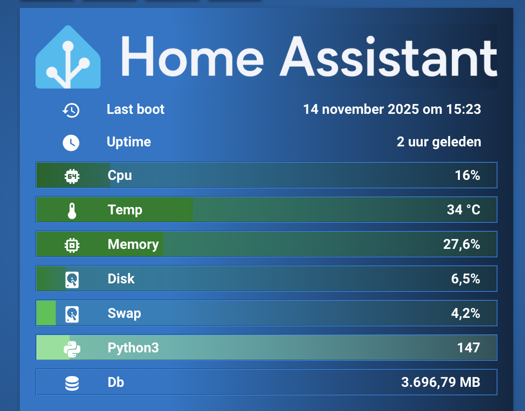

general update to my original card, required because nowadays (not sure when it was introduced) Ha sets an active background to an entity when returning from its more-info dialog, called focus-visible, resulting in this seemingly unstyled row (which in fact is getting the focus-visible…. :
with guidance from @dcapslock how to set a background to none in that case, we arrive doing this
    uix:
      style:
        # see discussion at https://github.com/Lint-Free-Technology/uix/discussions/307
        hui-generic-entity-row $: |
          .row:focus-visible {
            background: none !important;
on each individual row. Ive thrown that in a yaml anchor to not have to repeat it, and final complete card is in the following yaml
Full card
type: entities
uix:
  style:
          height: 25px;
          padding: 0px 16px;
      ha-card {
        color: white;
        font-weight: bold;
entities:
    cards:
      - visibility:
          - condition: state
            state: 'on'
        <<: &picture
          type: picture
          uix:
            style: |
              ha-card {
          tap_action:
            action: more-info
          hold_action:
            action: navigate
      - visibility:
          - condition: state
            state: 'off'
        <<: *picture
    format: datetime
    <<: &no_border
      uix:
        style: |
    <<: *no_border
    uix: &perc
      style:
        <<: &focus
            background:
              {% endif %}
  - entity: sensor.processor_temperature
    uix:
      style:
        <<: *focus
            background:
              {% set temp = states(config.entity)|float(0) %}
              {% if temp >= 85 %} {% set bar = '255,0,0' %}
              {% elif temp >= 75 %} {% set bar = '128,0,0' %}
              {% elif temp >= 65 %} {% set bar = '255,99,71' %}
              {% elif temp >= 55 %} {% set bar = '255,69,0' %}
              {% elif temp >= 45 %} {% set bar = '255,140,0' %}
              {% elif temp >= 35 %} {% set bar = '255,165,0' %}
              {% endif %}
              linear-gradient(to right, rgba({{bar}},0.9) 0%, rgba({{bar}},0.9) {{temp}}%,
                                        rgba({{bar}},0.6){{temp}}%, rgba({{bar}},0.2) 100%);
  - entity: sensor.memory_use_percent
    uix:
      style:
        <<: *focus
            background:
              {% if perc >= 85 %} {% set bar = '255,0,0' %}
              {% elif perc >= 75 %} {% set bar = '128,0,0' %}
              {% elif perc >= 60 %} {% set bar = '255,140,0' %}
              {% elif perc >= 50 %} {% set bar = '255,165,0' %}
              {% endif %}
              linear-gradient(to right, rgba({{bar}},0.9) 0%, rgb({{bar}},0.9) {{perc}}%,
                                        rgba({{bar}},0.6){{perc}}%, rgba({{bar}},0.2) 100%);
  - entity: sensor.disk_use_percent_home
    uix: *perc
  - entity: sensor.swap_use_percent
    uix:
      style:
        <<: *focus
            background:
              {% set swap = states(config.entity)|float(0) %}
              {% if swap >= 768 %} {% set bar = '255,0,0' %}
              {% elif swap >= 640 %} {% set bar = '255,215,0' %}
              {% else %} {% set bar = '50,205,50' %}
              {% endif %}
              linear-gradient(to right, rgba({{bar}},0.9) 0%, rgba({{bar}},0.9) {{swap}}%,
                                        rgba({{bar}},0.1){{swap}}%, rgba({{bar}},0.1) 100%);
  - entity: sensor.system_monitor_open_file_descriptors_python3
    uix:
      style:
        <<: *focus
            background:
              {% set py = states(config.entity)|float(0) %}
              {% set max = 2048 %}
              {% set percent = (py / max * 100) | round(1) %}
              {% if py >= 2000 %}
                {% set bar = '255,0,0' %}          {# Red #}
              {% elif py >= 1500 %}
                {% set bar = '255,69,0' %}         {# OrangeRed #}
              {% elif py >= 1000 %}
                {% set bar = '255,140,0' %}        {# DarkOrange #}
              {% elif py >= 500 %}
                {% set bar = '255,215,0' %}        {# Gold #}
              {% elif py >= 250 %}
                {% set bar = '173,255,47' %}       {# GreenYellow #}
              {% elif py >= 100 %}
                {% set bar = '144,238,144' %}      {# LightGreen #}
              {% else %}
                {% set bar = '0,128,0' %}          {# Green #}
              {% endif %}
                                        rgba({{bar}},0.9) {{percent}}%,
                                        rgba({{bar}},0.6){{percent}}%,
  - entity: sensor.home_assistant_v2_db_size
