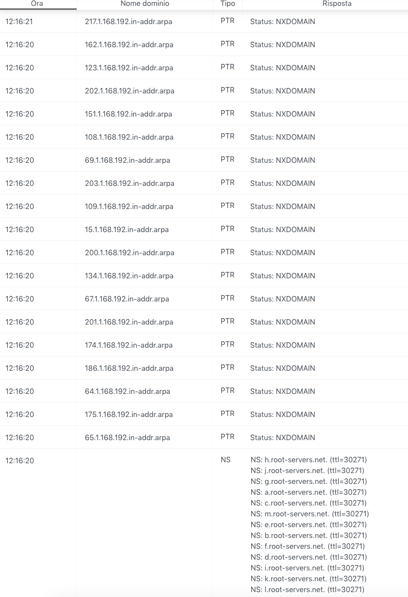

Hi all
looking at query log of AdGuard, I see a lot of queries coming from the HA IP address to various IPs all around the world
How can I know who is requesting this and why?
What is a PTR type?
Thanks
It isn’t a good idea to have HA point to it’s own add-on for DNS as while HA is booting it will not be able to resolve anything (as per docs) unless you have a fallback.
Personally I point HA to an instance of Pi-Hole that forwards to HA AdGuard. Pi-Hole falls back to another forwarder if AdGuard fails. Yeah, I know…
Actually, I’ve moved AdGuard from HA addon to a tiny RPi Zero W exactly for this reason.
So HA point to AdGuard IP address as DNS, that is (should be) “always” alive
Good plan! I’d seen these requests but never checked to see what they were.
