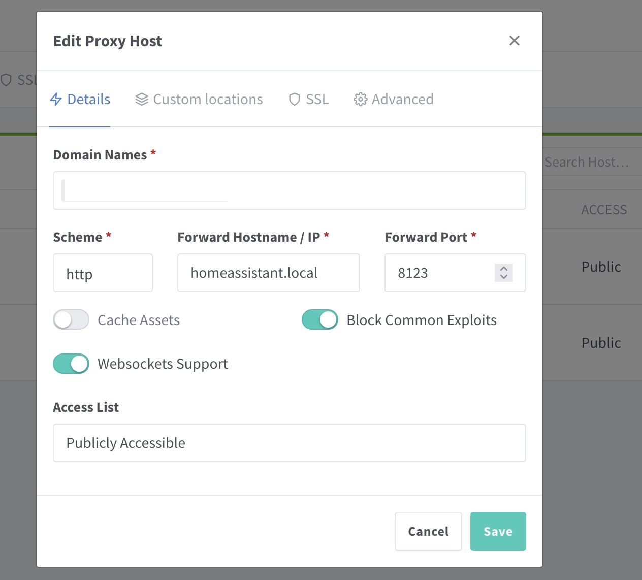

  3. Create a new proxy host that redirects to HA (see the screenshot). Your Domain Name is your public available domain and sub for home assistant, for ex: homeassistant.mydomain.com

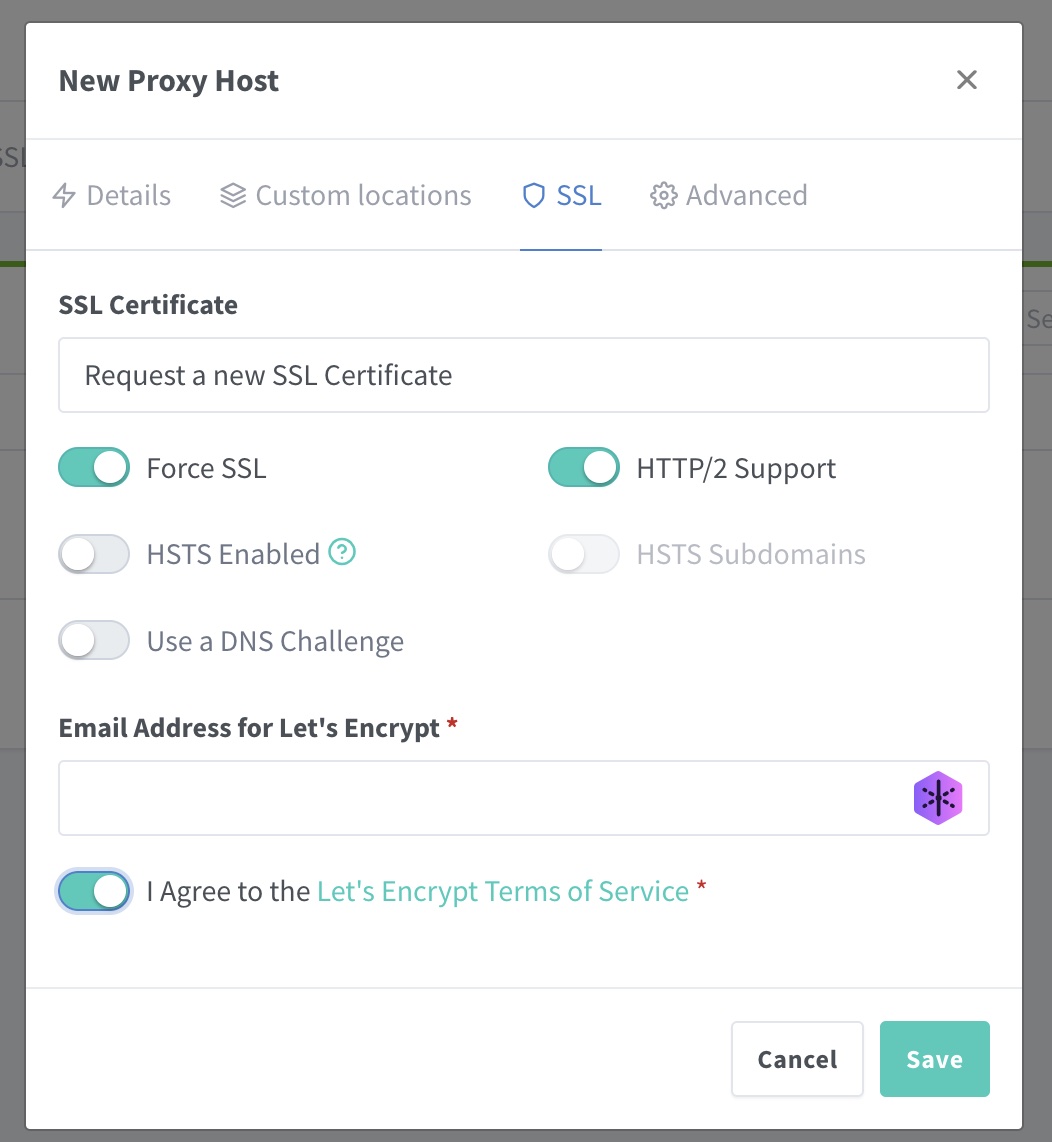

  4. Create a new SSL certificate. Put your email address and agree to the term of use. If you use an external DNS provider (I use for ex. Route53 from AWS) you need to check the Use DNS challenge option and then you can follow this doc: addons/letsencrypt/DOCS.md at df9bfbe2d4f5ee5597a0471e6c872da82ab3996d · home-assistant/addons · GitHub . If not, uncheck this option.

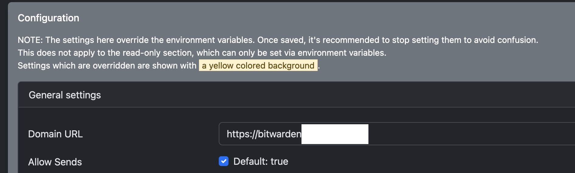

  2. In the admin panel you need to add the URL you want to use for your BitWarden instance, for ex: bitwarden.mydomain.com

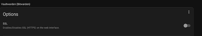

  3. In the BitWarden addon configuration, uncheck the SSL option and restart it.

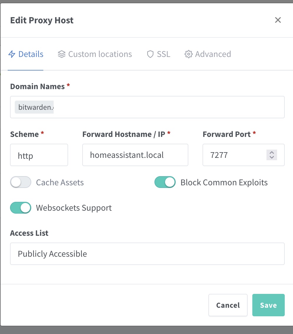

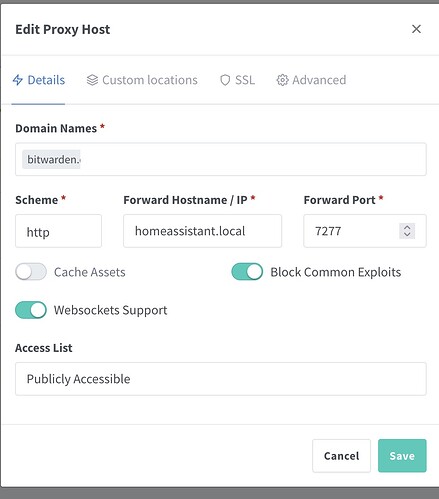

  4. Create a new host in Nginx as per previous point 4. But using your bitwarden URL, for ex: bitwarden.mydomain.com. You need to redirect to the bitwarden port 7277.
  5. Create a new certificate with SSL as per previous point 5
