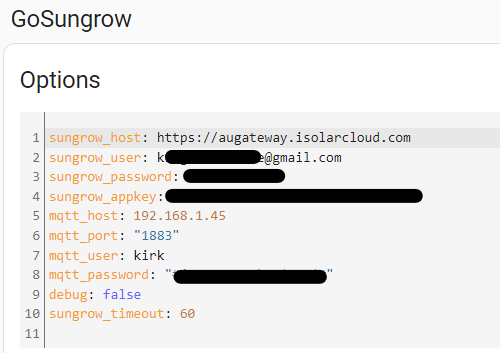

How’d you go Jarrod? I’m having a very similar issue. I have HA installed on a RaspberyPi with the Mosquitto broker addon for MQTT (MQTT - Home Assistant). I’ve tried setting the the MQTT_HOST in the configuration to ā€œlocalhostā€, ā€œhomeassistant.localā€, and even the IP address of HA… no dice. I keep getting the error following error. Interestingly ā€œkirkā€ is my username.
Error: network Error : dial tcp: lookup kirk on 127.0.0.11:53: no such host
Hi Kirk,
Yeah still no go unfortunately.
My Config - very similar:
My MQTT Broker as you see is 10.1.1.165, which is the IP of a container in a Qnap NAS. ( 165 is the actual NAS IP) But HA is in a VM in the NAS. the VM is allocated 10.1.1.171.
I just tried to start the add on again just now to show you the error message:
I’m not a coder, or a network engineer - I’m hardware, so this one has me a little stumped. :frowning:
If you sort it, please let me know!!!
Cheers,
Jarrod.
