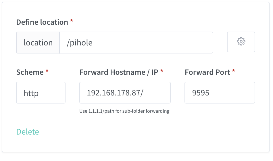

I don’t fully get the issue I’m having:
My main proxy forwards my domain to Hass, which fully works as expected.
However I also want to add domain/pihole to forward to Pihole.
This only works when entering domain/pihole/ and not domain/pihole
Question 1: Maybe bit lazy, but why doesn’t it work without backslash?
Question 2: And the domain shows as not Secure; expected that the https initial link to NGinx, would also make http address of pihole, show as being secured.
