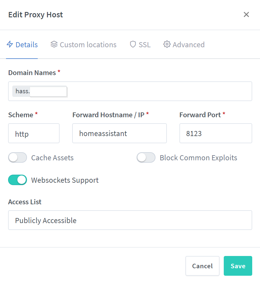

I solved the problem on my system. When I initially setup Nginx proxy manager, I did forget to turn on “Websockets Support” in the proxy host configuration. After turning it on, everything is now working as expected.

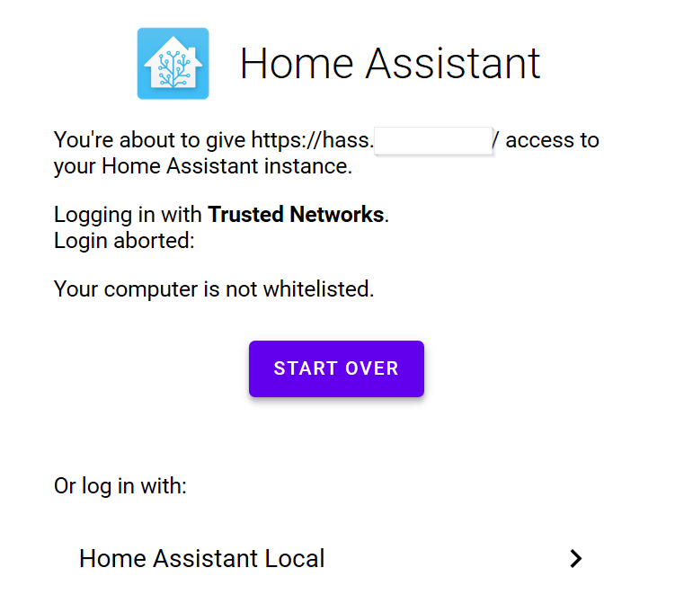

I’ve got the add-on running fine but when I try logging in with Trusted Locations from clients that are on the allowed subnet it doesn’t work. I get the following error:
I’ve tried adding X-Forward-For config in the proxy config to no avail.

Custom config on proxy host advanced setting to enable X-forward:
proxy_set_header X-Real-IP $remote_addr;
proxy_set_header X-Forwarded-For $remote_addr;
proxy_set_header X-Forwarded-Host $remote_addr;
real_ip_header X-Real-IP;
real_ip_recursive on;
Host settings
To clarify, logging in with username / password works fine but i would like login via Trusted Networks to work when at home.
Any ideas on what I can do?
Thanks in advance!
