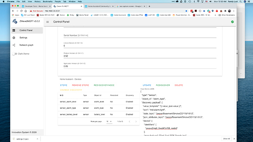

I have set this up and I am getting the devices and status in MQTT but not being discovered in HA.
Should these be imported to HA, or do Ihave to config them?

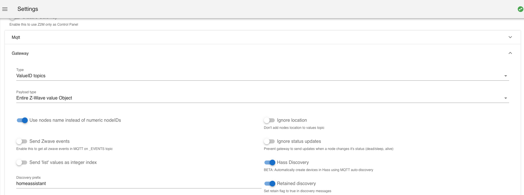

Did you set Settings > Gateway Hass discovery on and use the autodiscovery prefix that is in you HA?
Did you get this working it works fine for me it’s not in the drop down menu but can be set and saved! :slight_smile:
@DrJeff DrJeff I set auto discovery. I do not know what the auto discovery prefix is.
I used zwave. How do I find the prefix in my HA system?
It is in the MQTT settings on HA

Once you have that then when new devices are created HA will pick them up in MQTT, If they exist then you might need to restart HA to see them
Thank you, that is what I also did eventualy and now it works fine,
Also Thanks!! I now have my First Alert in HASSIO!

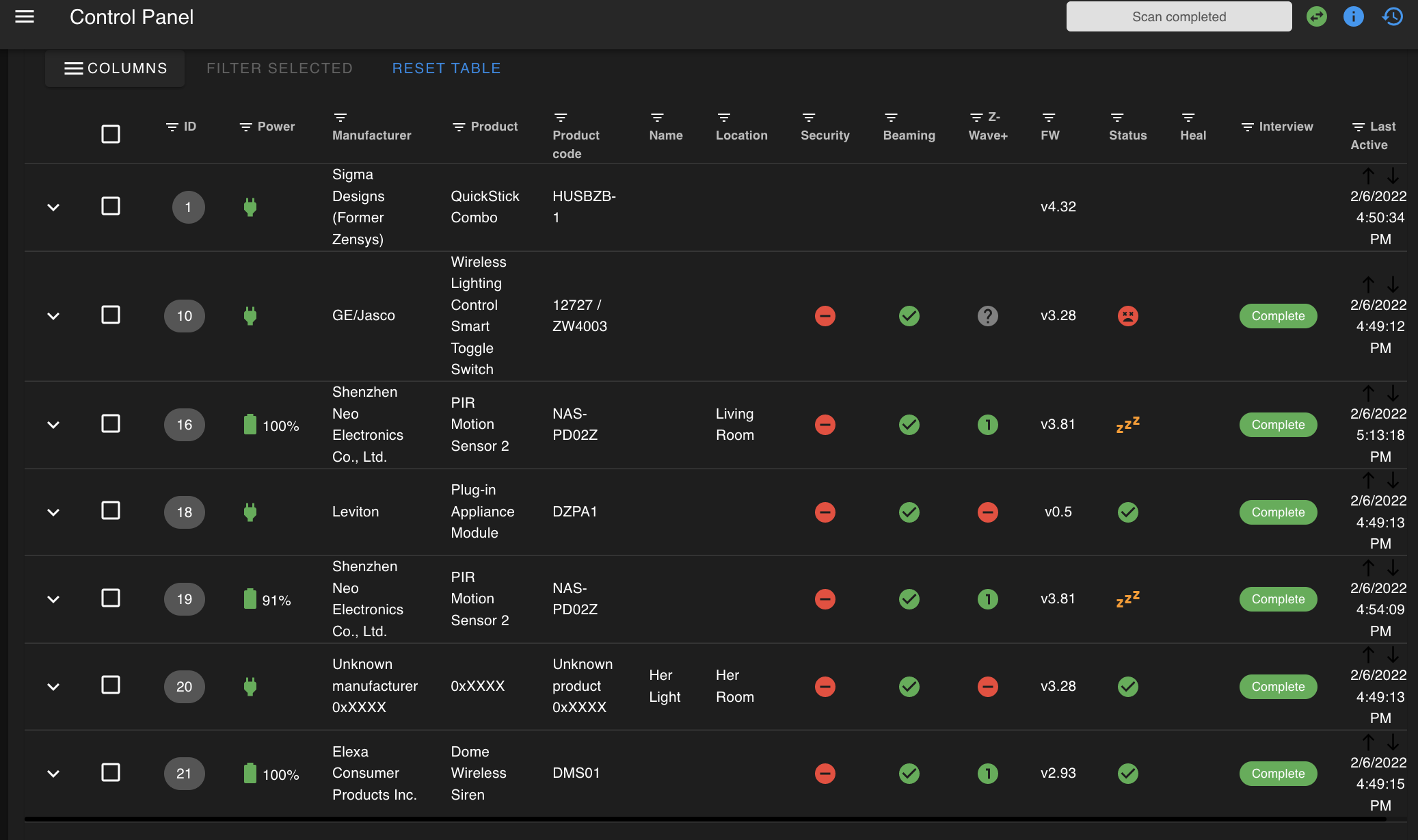

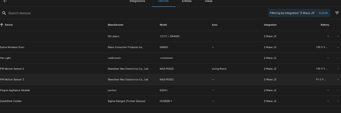

Unable to properly manage Z-Wave devices sense reinstall.
So I made the mistake of turning on ā€˜HTTPS’ within the ā€˜Z-Wave JS to MQTT’ web UI and was getting the 502 error. Ever since a full reinstall, I am unable to get to the devices through the ā€˜integration’ and properly Rename and Set Location. Sometimes they are grayed out sometimes I can type want hit update and it just sits there. Worse a couple had the new names show after I rebooted the system.
What I did:
Removed ā€˜Z-Wave JS to MQTT’ and ā€˜Z-Wave JS’ Add-Ons
Removed the Z-Wave JS integration.
Rebooted the server and rebooted the host.
Removed MQTT Add-ons and integration.
I then:
Reinstalled MQTT Add-On
Reinstalled MQTT Integration
configured both as I have in past.
Reinstalled ā€˜Z-Wave JS to MQTT’ Add-On
Reinstalled the Z-Wave JS integration.
For each, I actually followed the documentation steps as I had set this up many many months ago and was working flawlessly until the HTTPS blip.)
Can’t figure out what I have done wrong! It is driving me INSANAIN that I am unable to customize each device as I have done in the past through the integration. Don’t get me wrong all the dives seem to work turn off turn on and report but I like to fully customize more and I am unable to do so now.
