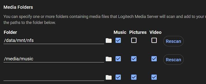

I finally bit the bullet and bought an i5 x64 micro PC and installed HA OS, and kick myself for not having done it a long time ago.
It works brilliantly, except for this community addon. In LMS Settings, Basic Settings, Iâve tried more formats than I can remember to add the TrueNAS Core guest share to the Media Folders, and nothing works.
Would someone, please, advise me what should be used in the box to access the Music folder? On TrueNAS Core, the path is mnt/Vol2/Music.
Thank you before I go nuts.

Have you installed the add-on for accessing external folders? I have more or less the exact same setup. I would have to look a bit closer as I got this going nearly 12 months ago. This is what the settings window on LMS shows
I remember having to add the following in config:
Happy to help out if my memory allows
Pat
Thanks Pat,
Which config file do you mean?
Frank

when you install the LMS add-on you input that info in the config section under options.
Pat
