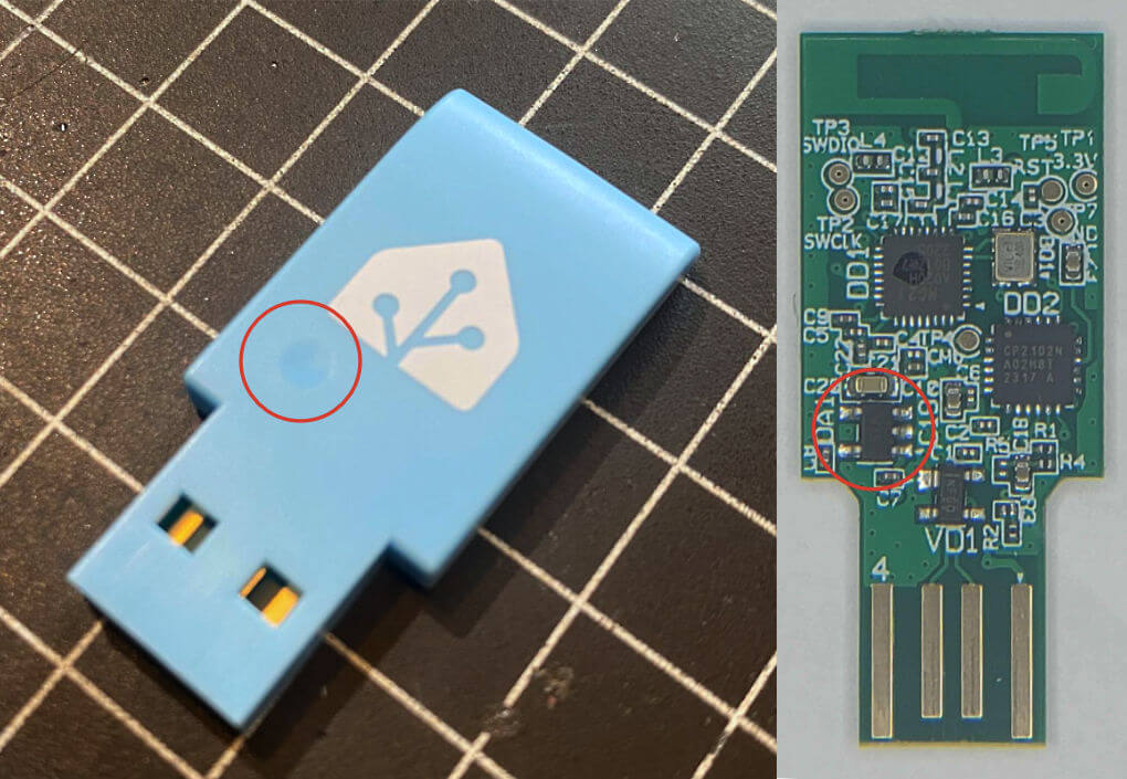

Around a month ago, we were contacted about one of our latest (and recently rebranded) Home Assistant Connect ZBT-1s not being detected and showing a small mark on the housing. A couple more similar issues were reported, and we began a dialogue with the small number of people who were affected, having them send us the devices to test.
Circled in red the deformation on the case and the board showing the failed chip
When we opened them, we found a dead voltage regulator. The mark in the outer casing is a sign that it overheated and failed. All of our devices are certified by CE and ROHS, and the plastic shell has been designed not to combust. This is a real-life demonstration of just how important this certification is and why we take that step.
We replaced the voltage regulator on the devices we tested, and the devices sprang back to life. We found our culprit, but why was it failing? As mentioned, the SkyConnect internal design and the manufacturing were effectively identical to the ZBT-1, and we received no reports of any such failures in the literally tens of thousands of them in the wild. In manufacturing runs there is always a little variance, and in this run, something went wrong with the voltage regulator that was sourced - again, we’re looking into this.
It took us a couple of weeks to replicate the problem with our own units. We went down some wrong paths, but eventually found it was triggered only by certain devices, specifically certain desktop PCs (internally, we have only found one desktop that causes this failure). We have not observed the failure occur when the device has only been connected to a Home Assistant Green, Raspberry Pi, or even a Mac. If you have plugged your ZBT-1 into a different device, specifically a desktop PC, and it is not recognized by that system, inspect it for this deformation pictured above. Obviously, we want you to be able to use the device with any hardware, and even if only a small number of devices from this batch have reported issues, it is still unacceptable to us.

I checked my Home Assistant SkyConnect or atleast that’s what i think it is, i bought it on June 11 this year, two days before the ZBT-1 announcement.
it shows a faded area in the same placement, and has only ever been connected to a Home Assistant Green.
It’s still working and has worked flawlessly since purchase, but it concerns me that it also shows this faded area.
Do all units have this faded area on top of the regulator or only ones that have this defect?
You shouldn’t be impacted by this based on when you bought it. As long as it works, it should be fine - what you want to watch for is warping of the plastic itself.
Quick edit to add: It will absolutely stop working if you are impacted. :slight_smile:
