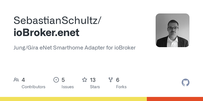

I do not have a home assisstant but I have been trying to get an API for my eNet smart home for years. I am not fluent in JavaScript but I know Python and C#.
Currently I know about these 3rd Party API Integrations:
  1. GitHub - SebastianSchultz/ioBroker.enet: Jung/Gira eNet Smarthome Adapter for ioBroker
    It uses some kind of obfuscated blob for communicating with the eNet server. From the communication in the repo it seems to me like they got the blob from Gira/Jung? It works ok’ish with ioBroker. I am using it actively but my satisfaction is rather meh

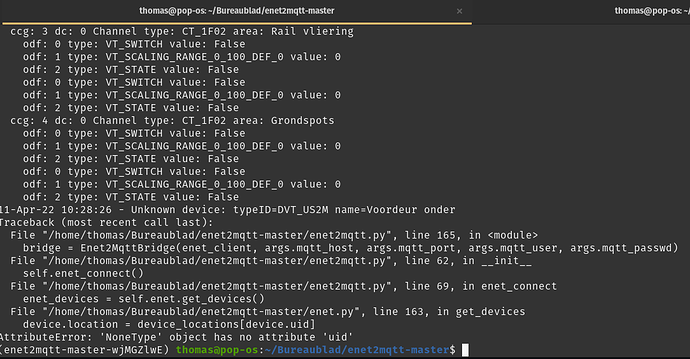

Hi!
I got this error:
Do you got any idea what I am doing wrong?
~Thomas
Hi Thomas!
Ohh - could it be that the device type is not reconized in the code?
the DVT_US2BM is not recocnized - but because none of us - had that device type.
But if you look into the enet.py file - the Device class is defined. right now we have 2 subclassed
which is Light and Switch.
the voordeur onder - what type of device is this? :slight_smile:

EDIT: So if I added to the list it is fixed?
Hi Thomas! Yes - first thing is to add it to the list.
If i remember correctly - it will be added as a light still - but without dimming capabilities.
But it should work - by adding it the array.
Also - if you would like to behave as a switch - i think it should be manually set to this inside HA. i haven’t done so yet - but simply changed the icon :slight_smile:
Unfortunately, it still does not work.
Any idea?
it says NoneType - that is a bit strange.
because it looks like it doesnt get the attributes of the device.
Now - i am not sure if the device type (as i dont have that type in my setup) is a special device - with different proprties - because it should be able to finde the uid of the device.
You might have to setup a postman connection to you enet server / or look at the developer tools from google - to see the properties of what is returned from the enet server.
also you could try to simply debug the python code - and what it does.
Okay, I got it as far as this…
Would you mind sharing your dockerfile, so I can take a look at it and figure out what I am doing wrong?
Already thank you!
