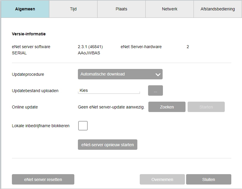

Hi All!
Nice to see all the work done on the enet server.
I still run my “own” version on a very simple docker container - on my linux server.
I can confirm that i dont use https to connect - only http.
My software version of the enet server is 2.3.1 - and hardware version 2.
Best regards Ronni
Heyhey! I just got my enet server to switch to https. And for me, it just works…
What I think is your problem now because I can’t think of something else, is that you guys have other devices than me, like switches. You can verify this with this tool: https://github.com/lawrencebensaid/enet-api Compare it with the list in enet.py. Because I had a kind of similar problem without the https problem.
