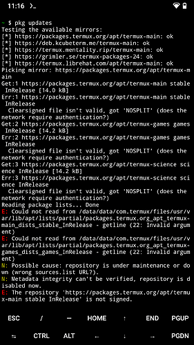

This may be out of the scope of this guide, but I’m having some issues just getting Termux running on a Galaxy Note 4 running Lineage 18.1. I’ve attached screenshots of what Termux is saying; if anyone could either help me understand what’s going on or point me to the right place to get help, that would be great!
Looks like the repository might have been down when you tried. Give it another go or do a clear cache/data from Termux then try again.
