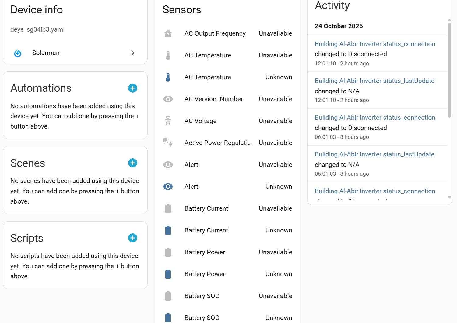

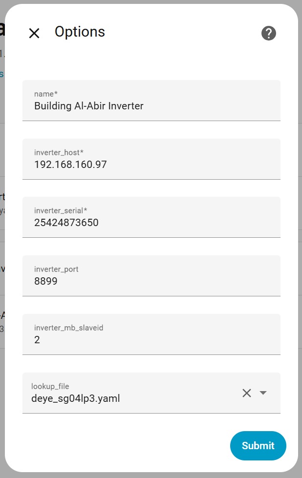

Thank you for your help but it isn’t working for me, I entered my deye dongle information on solarman but it still gave me unknown data, the dongle has wifi and connected locally to home assistant as well. How did you get it to work? To add I have other non deye dongles and they worked fine on solarman, only deye is giving me issues.
try deye_hybrid as a lockup file, also check if you use correct component because there is two components with same name, and this from david drapan is better :slight_smile:

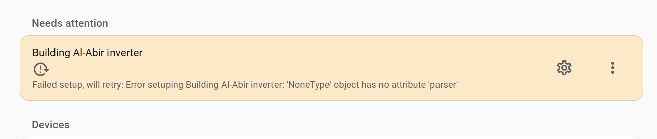

I used david’s solarman but sadly it didn’t work as well, any new ideas to help?

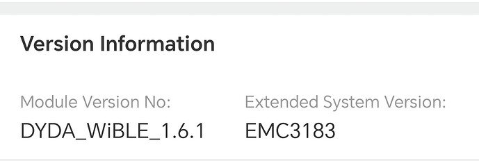

Hi everyone, I have been trying to integrate my new deye inverter also, but as far as I understand deye has new loggers as you can see on the image. I think this is the main reason why we can’t get it work. Do you know any other workarounds that we can get info from the inverter even if it is laggy (cloud) because I don’t have the opportunity to get other loggers as there is none in the country where I live. I am using deye cloud for the time being. Thanks for any help in advance. :pray:
Hola, no se si habréis conseguido conectar con el Inversor, yo tuve el mismo problema y tuve que cambiar la dirección del esclavo del inversor, en vuestra foto de configuración viene un 2 y por ejemplo en mi inversor esta configurada como 1, tenéis que ir al inversor y buscar en los parámetros de configuración este valor

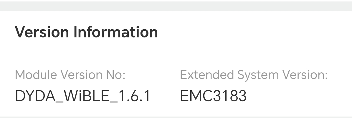

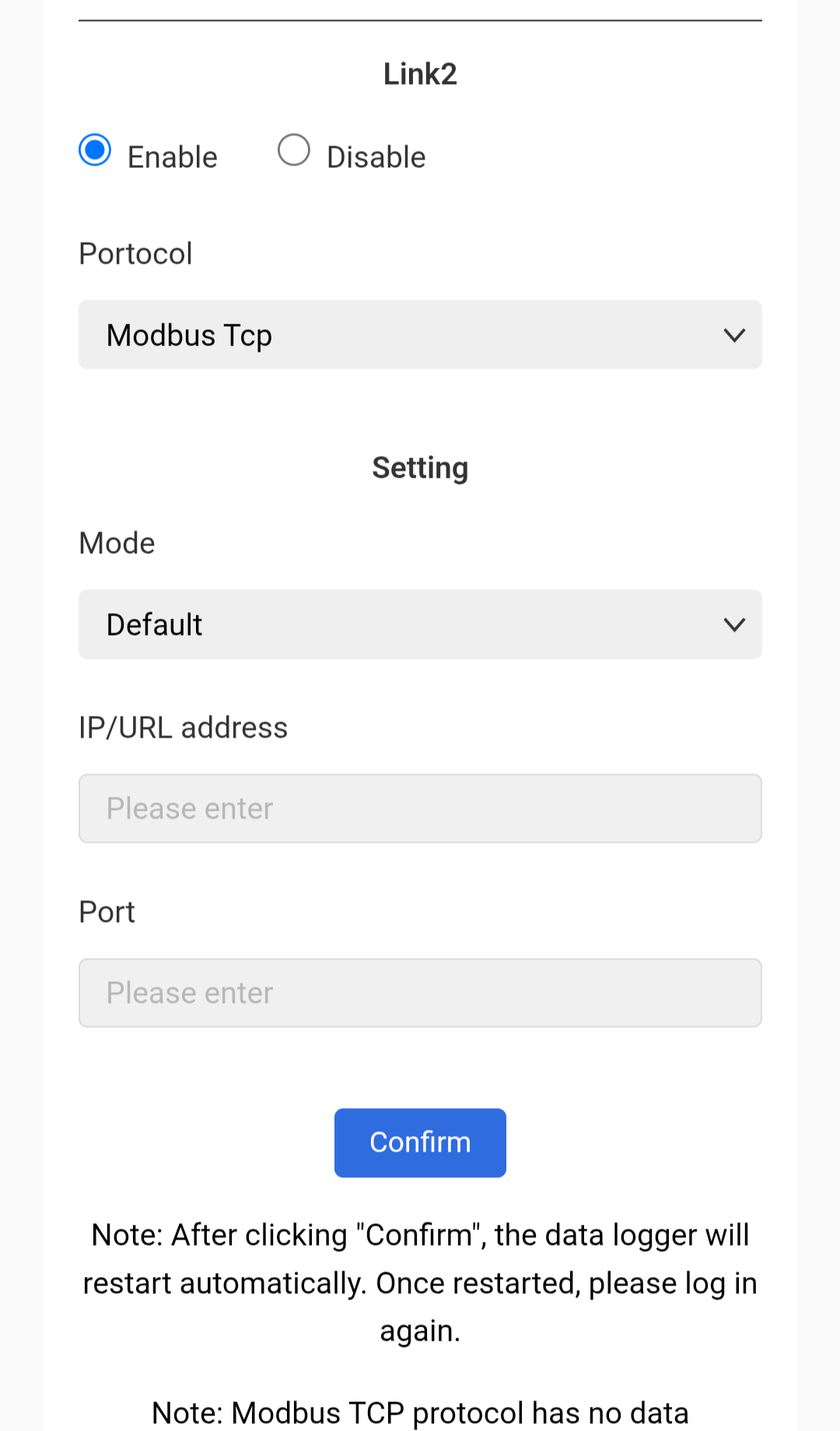

For ones having issus with new Deye data loggers (mine was DYDA_WiBLE_1.6.0).
I sent request for remote firmware update/unlock for my Wi-Fi data logger to enable local V5 Modbus TCP access for local Home Assistant integration to Deye support.
As a result (within one day) my fw for logger was updated to DYDA_WiBLE_1.7.1_crypt.
Based on support comments:

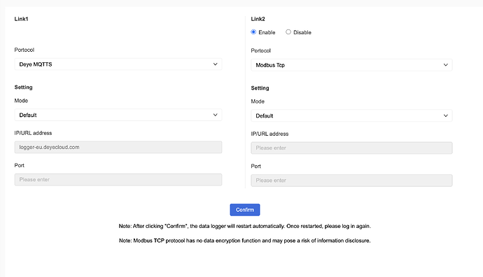

The new firmware for the WiFi logger, version 1.7.1, does not support Modbus TCP 8899 and only supports Modbus TCP 502
For this to work first you need to enable it on data logger (via its web ui)
Then my Solarman integration worked without issues (don’t forget to use port 502)

What are the admin default username and password so I can access that menu to configure MODBUS? Is there any repository with this version of firmware?

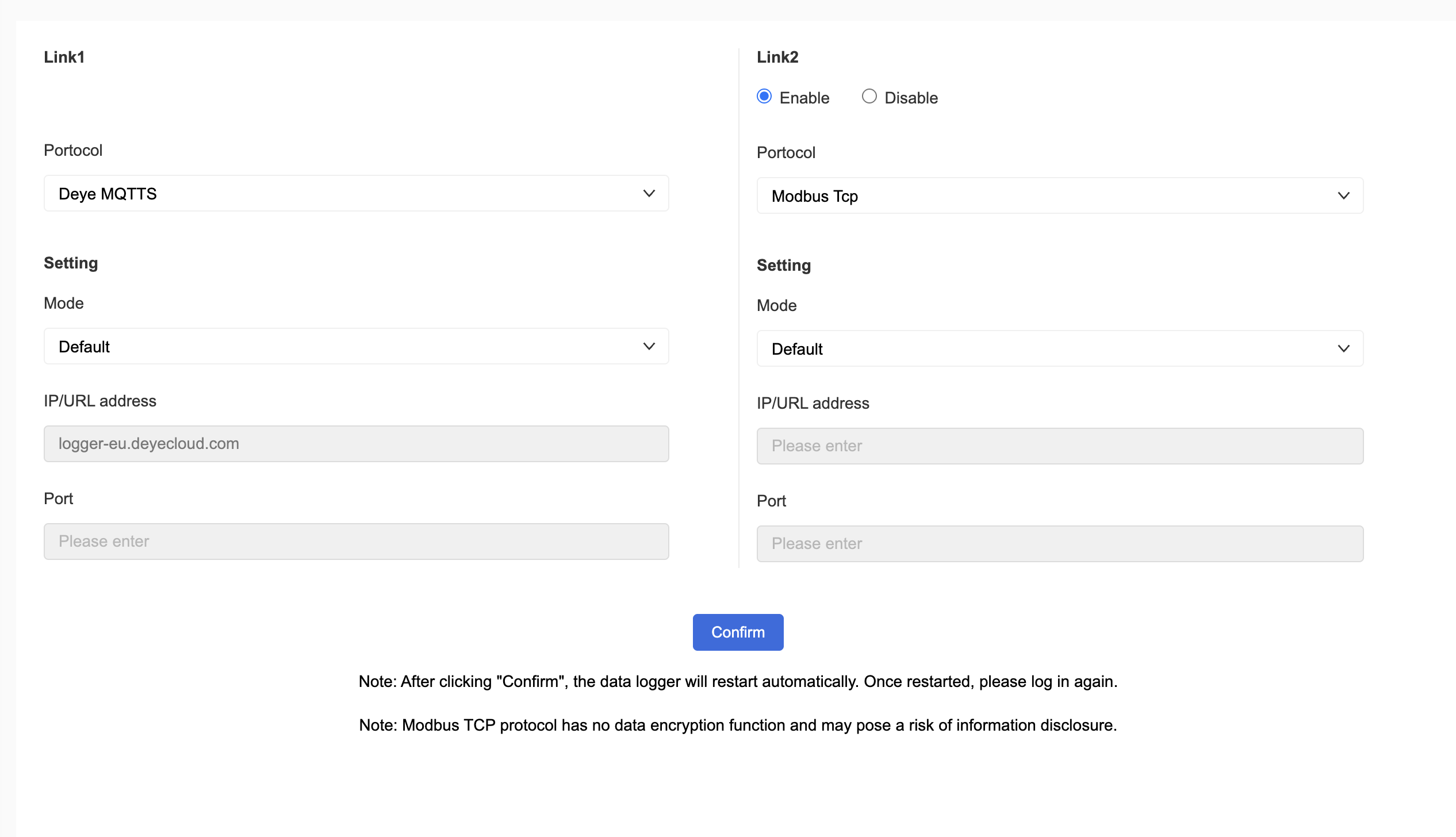

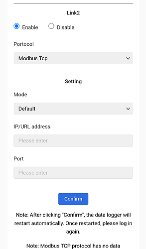

I didn’t contact support, and the firmware hasn’t been changed.
Loget UI
username: admin123
pass: from loger
Enable link2
