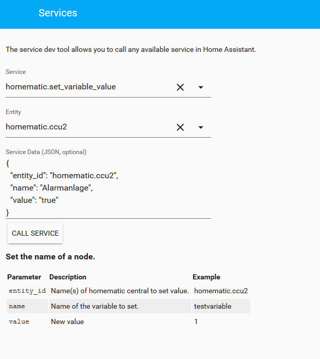

Anyways one last question, can i set a variable for the ccu2 from home assistant (need this for HM-Dis-WM55) so to speak that i can change a variable with home assistant for the ccu2?
For me that works without a problem. Did you have a look at the logs while calling the service? Maybe the problem that prevents you from receiving the variables also prevents you from setting them.
PS: For a boolean variable all these variants should work (they do for me):
Could you increase the log level to debug? I would need to see what exactly happens in the pyhomematic module. So just like the log messages you have posted earlier.
