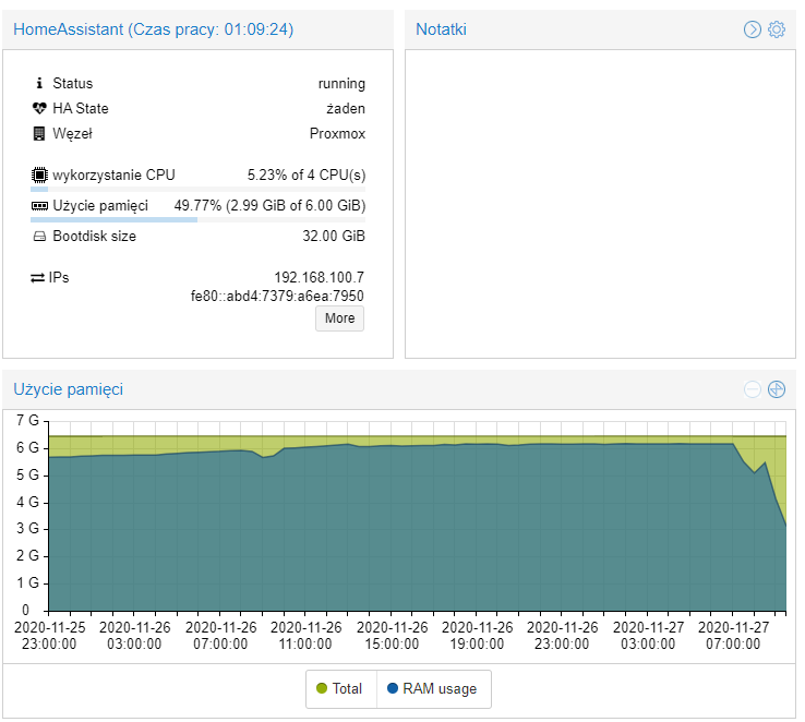

Hi, I have noticed the memory consumption related to nodeRed. The more automation, especially the subprocesses in subproces, the faster the RAM clogs up.
Try to restart Node Red, if you memory the consumption will be close to 100%
For me, the memory consumption - 6Gb takes about 5 days
Is it possible to do an automatic restart in proxmox for an hour, e.g. 02:00?
