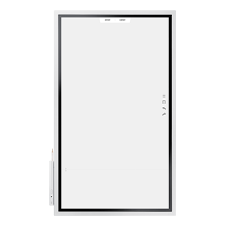

I am considering building a large home control screen in the kitchen using this device (I can get one really cheap):
You think that would work well with this application?
I googled the Samsung Flip and it seems it has a web browser, so it will work, but unless you get it cheaper than an old (maybe non-smart) TV of the same size it would be a bit overkill as a control center.
Also, it seems it has HDMI OUT only…I believe that any screen you chose should have HDMI IN functionality for a smart home control center so you can link a RPI or any SBC you like to it and have a standalone system
But to answer shortly, since i don’t know what oter applications you have for that board, it will work in the web browser
