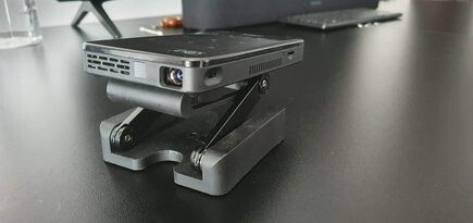

The basic idea is very simple; I have rail lighting with Cinema Track Projectors with the E27 socket, bulb, and the rest of the electronics stripped out and everything inside was replaced with a DLP P09 projector on a stand and a DIY power supply-adaptor-thingie (official name).
The projector has a standard tripod screw thread which allows me to fit it on the stand and then, through extremely precise eyeballing measurements I managed to fit that stand perfectly (ish) horizontal inside the light projector. . . and any hypothetical misalignment is solved by software/keystone correction.
https://imgur.com/a/3ka9Owq
The power supply-adaptor-thingie (that is completely wrapped in electrical tape on the final build) is made out of a random modular power plug connected to a Shelly 1 relay following this connection scheme. I would recommend using the Shelly 1PM 220V relay instead but I only had a dry contact at hand.
The supply-adaptor-thingie is there to power the projector from its original charger, which I didn’t want to cannibalize just in case I decide to take it out at some point, and is electrical input comes from what was initially at the ent of the E27 light socket, getting power from the lights electrical rail.
The point of the relay is to regulate charging of the projector, since it is powered from the light network, I don’t want it charging every time I turn on the lights (even for only 5 minutes) to preserve the life of the battery.
The projector comes with an integrated battery so it will work even if the lights are off (since it is powered as a light bulb)…it will also work when the power is completely off…but probably no netflix/internet/etc.

In the th video you wans see the projector inside the “light shade”, ie the cinema “light”
@smowk that is a great job.
I have a question about the projector though - the advertising refers to 4k, but the specs say the resolution is “WVGA 854x480”
I know you are not using it in a home theatre, but that seems a contradiction in the advertising.
It is advertised as a 4k projector because it can decode 4k video from a source and ‘project’ said video at WVGA resolution.
Most Chinese products are advertised in such way, but the actual video quality is really good for it’s size and price…plus, I’m not trying to get a 100" video projection out of it
