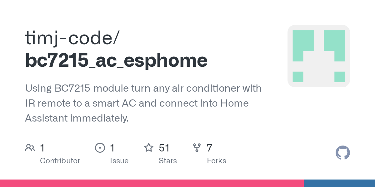

I believe my project will work for you if you like to try it.
