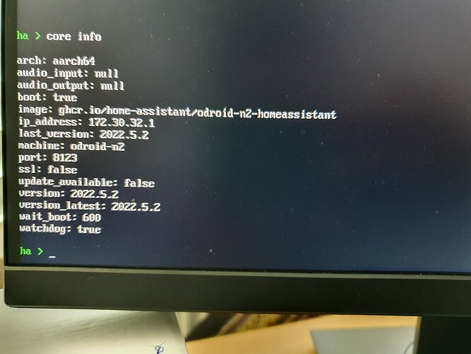

Below are screenshot right sfter the system loading up . the core log and the supervisor log
I stopped the core (Core Stop) and when I asked for the system to start the core ( Core Start) I receive below error message

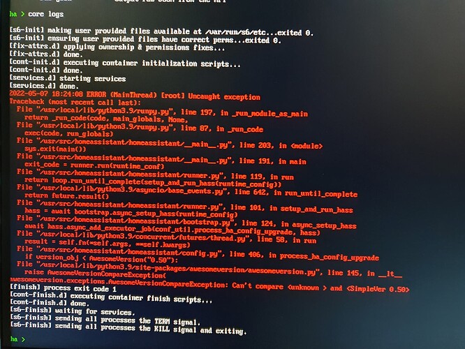

And checking the supervisor log suggest that the HA crashed:
… Error (Mainthread) [supervisor.homeassistant.core] Home Assistant has crashed!
Another thing I tried was to rebuild core whcih also failed and I received exact same error message as above and supervisor log shows the HA has crashed.

This is what I get

I get below picture showing HA crashed

What does the log look like now?
Sure, please see below pictures .inclusions output of “supervisor logs” and “resolution info” commands:
Hmm. Home assistant keeps crashing. Try reinstalling:

Also in last picture I sent you (result of “HA Resolution info” command ), you can see that there is something wrong with the Core.

One last thing to try:
ha os update --version 7.6
You are running an older version of the operating system (v6.6).
