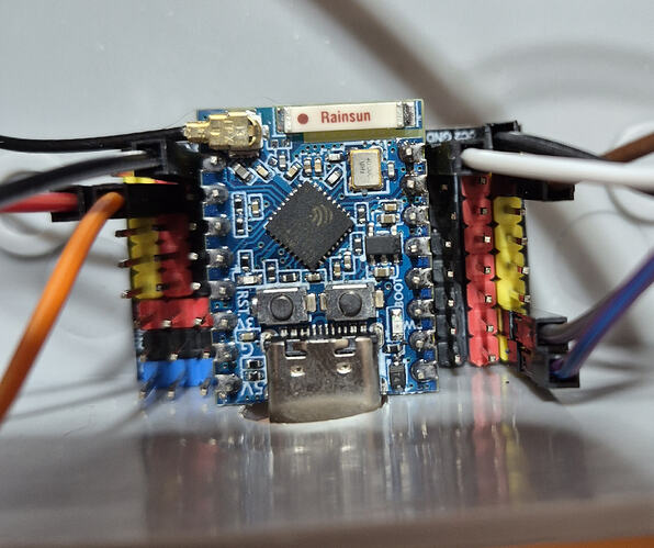

Hello everyone,
I’m having an issue after adding an ESP32-C3 Super Mini board using the ESPHome Builder. The board flashes without any issues and works, but for some reason, I cannot create more than one switch entity for it.

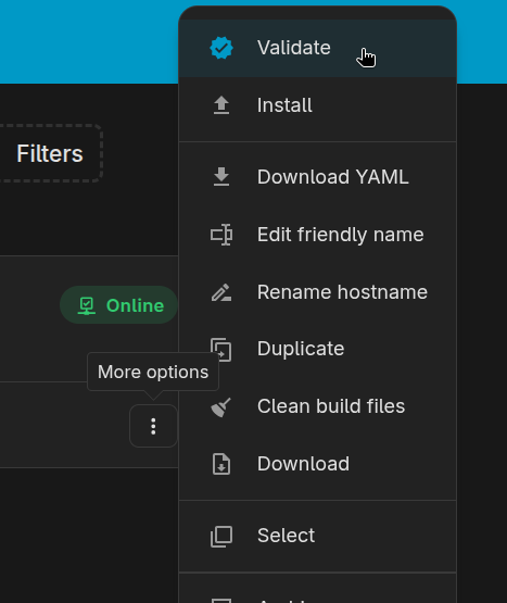

My goto first in ESPHOME is to run Validate first, to check the rendered yaml file i correct.
There are so more options that renders before the compile and install.
There you can see if you missed a obvious one.
Yes, I can see that. I received the message “INFO Configuration is valid!”
Yes, that confirms that, but if you look at the rendred yaml file, you will se that the ESPHOME add more options in your yaml file. So studdy this yaml and see if you get some hints whats going on.
