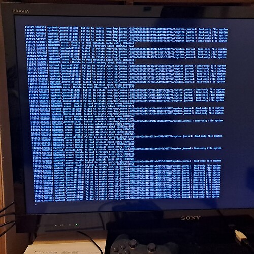

Luckily mine did, it just kept crashing every 5 hours or so. I connected the HDMI and saw that it was the SQUASHFS becoming read only and journald errors.
