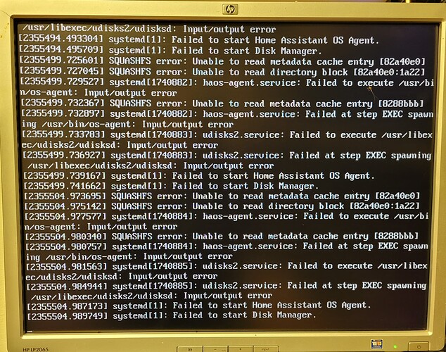

I just migrated my setup from a rpi3 to brand new intel NUC i3/256GB NVME/8GB RAM. I install the latest HassOS (5.12) on the nvme, no problem. I restore my snapshot and it failed : I have a ton of error :
Blockquote SQUASHFS error: unable to read metadata cache entry / unable to read directory block
Blockquote EXT4-fs error (device nvme…) ext4_find_entry … inode … cf. screenshot
So after some research I thought about a hardware problem. I checked the RAM with memtest86 → No problem. I checked the SSD with e2fsck -fv and badblocks -v → no problem.

It seemed to be fine for the first couple of days and then this morning I couldn’t logon - I got “Error: Something went wrong” on the logon screen. Connecting a monitor to the RPI4 I revealed loads of errors relating to EXT4-fs. I rebooted and it’s now churning out loads of SQUASHFS errors.

Was working fine till this start of this week then got some odd issues with ESPhome devices going off-line/rebooting, then tonight I started a Full Backup in prep to update the core to latest build, then splat… Now the RPi4B boots and runs for a while then system locks up on GUI and HDMI monitor shows endless EXT4-fs errors, SQUASHFS errors etc. Power restart ends up in the same place eventually…
Any clues from the image ?
