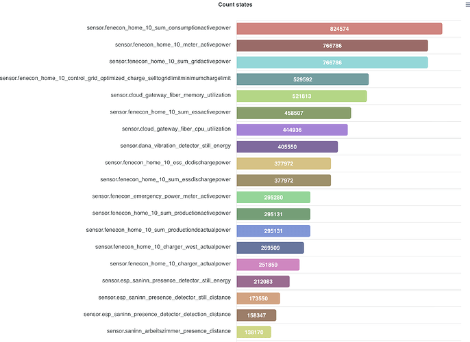

Maybe I need to focus on the DB. The sunny days are starting on my side of the globe and my (NEW) Inverter/Solar/Battery seems to be kind of noisy

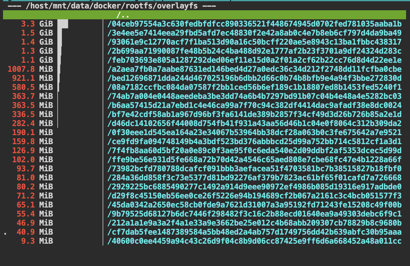

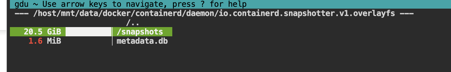

This tells you the problem - you have 25 containers (count your addons) installed and running with 4 images not running - you could reclaim the 4 not used but the 25 in use prob make the bulk of that 27G.
Read: You must construct additional pylon... er sorry wrong software - you need more space. Or you need to pull addons / apps out.
Yes maintaining good db hygiene is important dont NOT do that… but your db size will stabilize as after 10 days history starts to take over and help you clear the chaff long term. Your big problem is static storage rn.

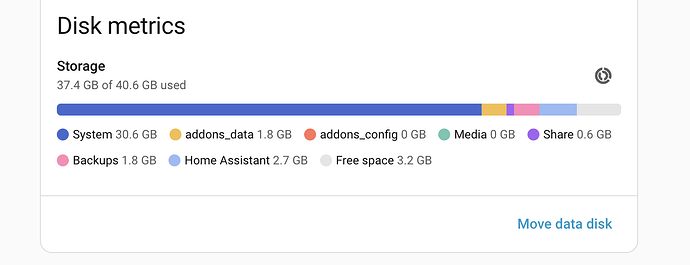

That said. you asked how big can it get? My BACKUP ALONE is 13 G - so… You prob need to look at more storage long term. My system volume on my HA box is currently 128G, but I’m about to double that as I get too close at the end of the month to 75% after my backups. 48 will be TIGHT no matter how you slice it.
Your DB is fairly “small”, And overall nothing really “sticks out”
Thou again the 3 “mentioned” APPs, is takes about +4Gb ( Really not much )
However as Nathan says, You need to Adapt to Your reality , Add more Space

I mostly keep my backups on a NAS, and for catastrofic failures depend more on the full VM backup to be honest, but yes you and @boheme61 are right. I need to think about my space, I try to keep it around “just what I need” because one I went uncautious and got a full storage error on my proxmox instance at. 10pm :smiley: not fun.
Also I learned now (thanks to someone on discord) that I am propably feeling this due this containerd image store | Docker Docs, that was introduced on Release Home Assistant OS 17.0 · home-assistant/operating-system · GitHub. I did gave my HA instance more space that time but looks like not that much.
I’m glad someone got that… It was either that or you were getting Fable Narrator energy…
‘your health is low’
As extra info. I followed this Proxmox VE Tips.md · GitHub to call trim on my VM and it recovered 9% of the disk
It changed from
  vm-100-disk-1 pve Vwi-aotz--   44.00g data        99.16
to
  vm-100-disk-1 pve Vwi-aotz--   44.00g data        90.27
