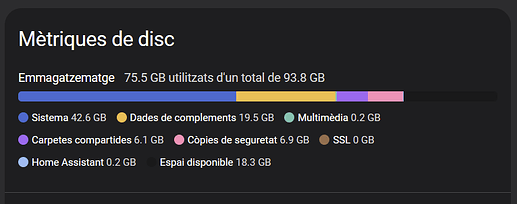

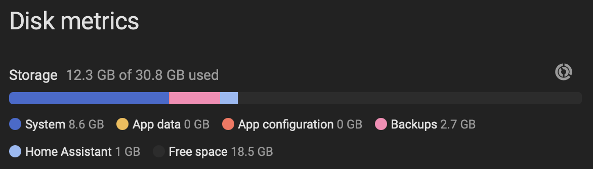

The storage data indicates that the system is fairly large
Upon reviewing the new Storage Insight feature, I noticed that the system takes up more than 40 GB of space.
That’s too much space, in my opinion. How can I see what’s taking up the space?

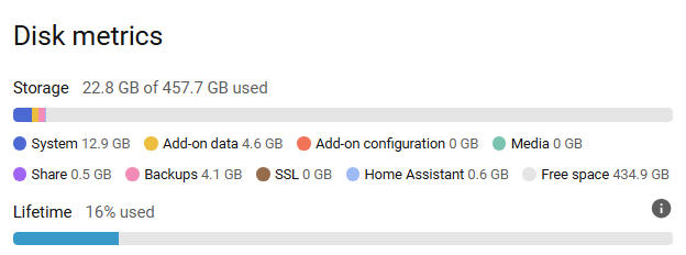

My NUC with HAOS on bare metal has 18.9 GB, so it must be counting other things to the system. I do hve my database in a Mariadb addon, so the recorder database might explain the difference. Although I must admit I would not expect that to be counted as system.

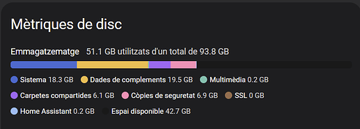

I was running out of storage space until I moved Frigate to its own server.
Now:
I found the following:
/mnt/data/supervisor/tmp 24.6 GiB
/mnt/data/docker/overlay2 26.8 GiB
In tmp, old broken backups are being stored, so I deleted them by connecting via ssh using this tutorial:

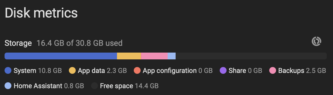

Yes you can see at my first site I have 0GB on my App Data, that’s after clearing ~5.5GB from ESPHome! Second site I hadn’t cleared that yet.

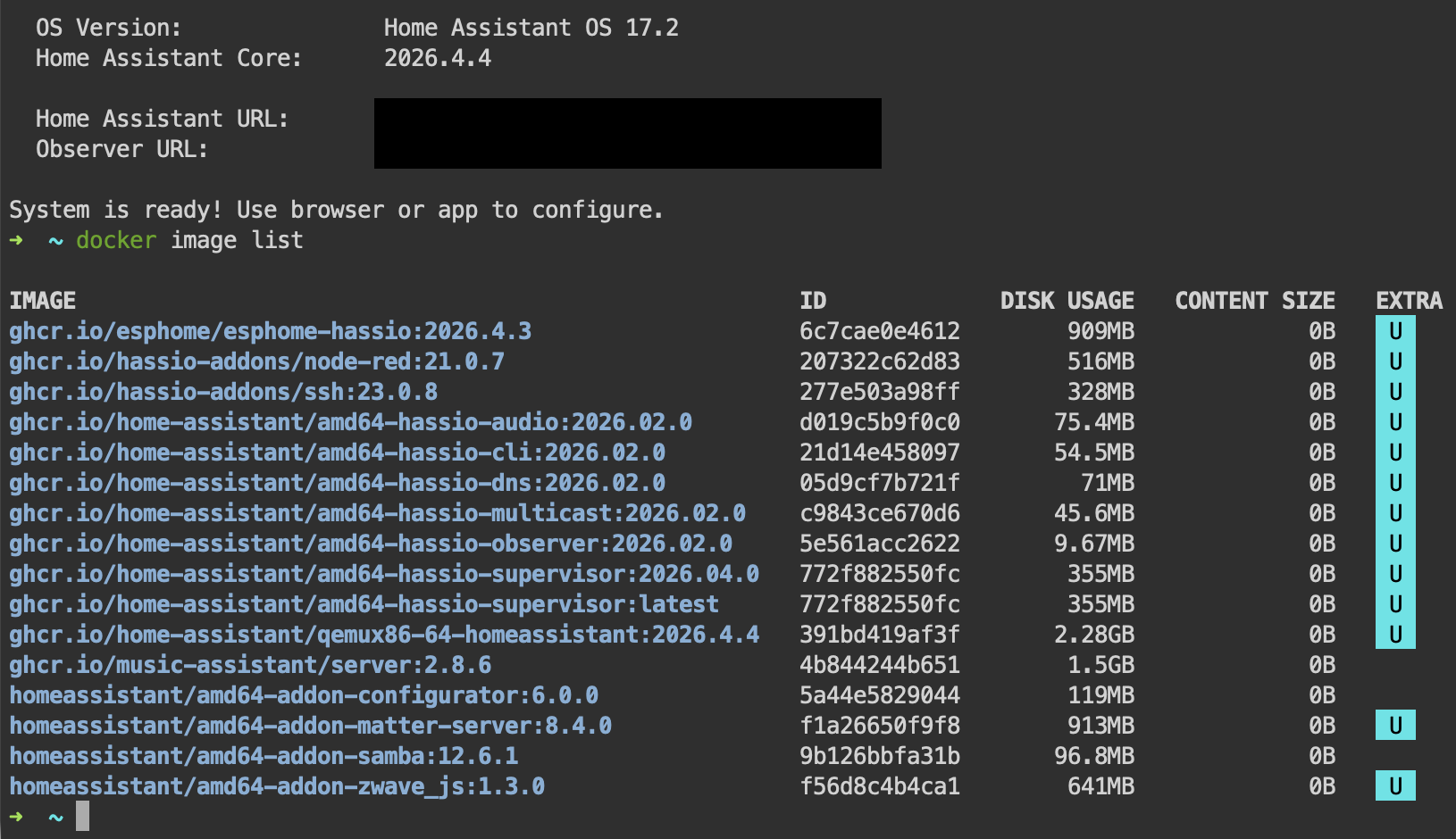

As for docker containers, looks like you’re right and I count about 8.6GB here!
(For some reason I cannot copy text out of Advanced SSH, so a picture will have to do)
By my maths, that’s ~8.6GB worth… which matches what is showing on my first server for “System”.
I’m not sure if there’s anything to prune here though? I currently have Music Assistant disabled, along with Samba disabled, but I don’t want those deleted accidentally in a prune, so not sure if it’s safe to try.
If there is a bunch of unused old container images, there definitely needs to be some focus on HA cleaning up after itself.
It’s not safe at all. Any addon which isn’t currently running will be removed if you run the prune command.
