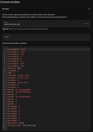

Looking at what you are trying to do it seems kind of overcomplicated. If you just want all values that would work like this:
rest:
  - scan_interval: 60
    resource_template: http://192.168.178.203/pages/getinformation.php?heute&datum={{ now().strftime('%Y%m%d') }}&meterindex=1
    sensor:
      - name: test_rest_one
        value_template: "{{ value_json.Leistung170 }}"
        json_attributes:
          - Leistung170
          - Leistung171
          - Leistung172
          - Leistung173
          - Leistung270
          - Leistung271
          - Leistung272
          - Leistung273
          - Waehrung
          - Stand300
          - M300
          - Stand180
          - Stand181
          - Stand182
          - Stand280
          - Stand281
          - Stand282
          - Kwh180
          - Kwh181
          - Kwh182
          - Kwh280
          - Kwh281
          - Kwh282
          - Kwh300
          - Betrag180
          - Betrag181
          - Betrag182
          - Betrag280
          - Betrag281
          - Betrag282
          - Betrag300
          - Metertype
Results in HA:
