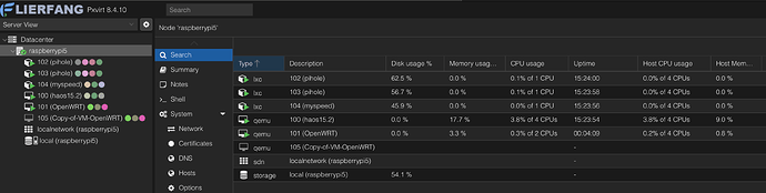

Finally after many sleepless nights i managed to solve this struggle, used Documentation Index of PVE, Documentation of OpenWrt and my priceless right hand Perplexity AI. On my humble (somebody would say overkill :D) homelab setup of Raspi 5 with 8GB Ram, 256GB NVMe Drive powered by POE (Fully metal closured to prevent any EMi/RFi) I builded ProxmoxVE from Raspi Debian destro, and deployed HaOS VM, which was easy and practically first thing i did in the Pimox. But it had much power available. OpenWrt as Router on The Stick was easy choice, but not so pleasant deployment as it doesn’t have available one-line Shell script for deployement, like HaOS do. But after all, it could be done by novice like me.
