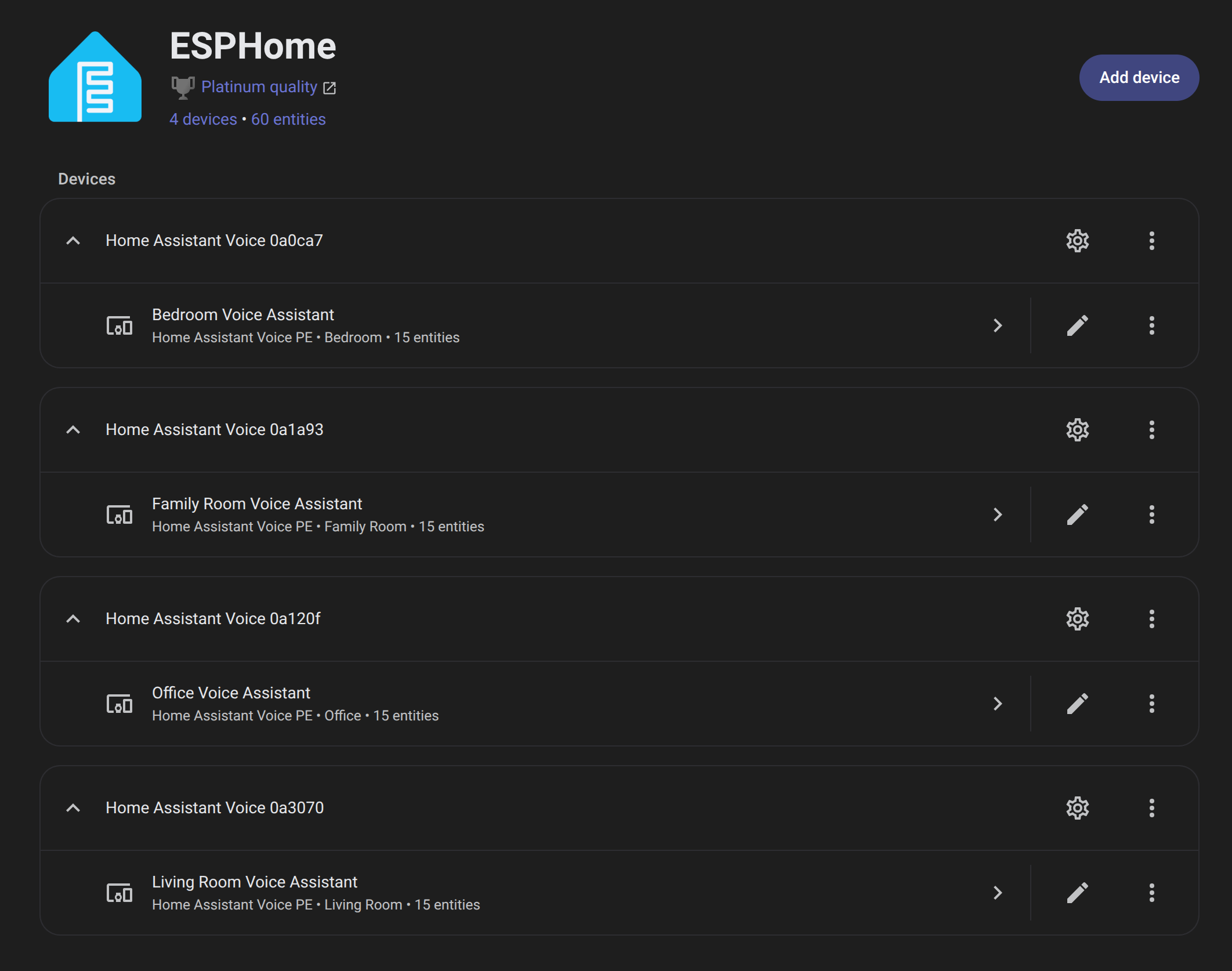

How are you guys even taking control of the PE box? I pulled down ESPHome Device builder and it just won’t see it.
It’s not visible by default, but there should be an option to see the device and adopt it.
You mean “Show Discovered Devices”? That doesn’t show anything.
It may be easier faster to just plug it into your computer and flash it with the yaml you want. After that it will be accessible OTA.
Is there like a default yaml for these devices? I tried just adding one via USB and it bricked it. I had to reload it from the website.
