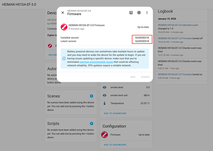

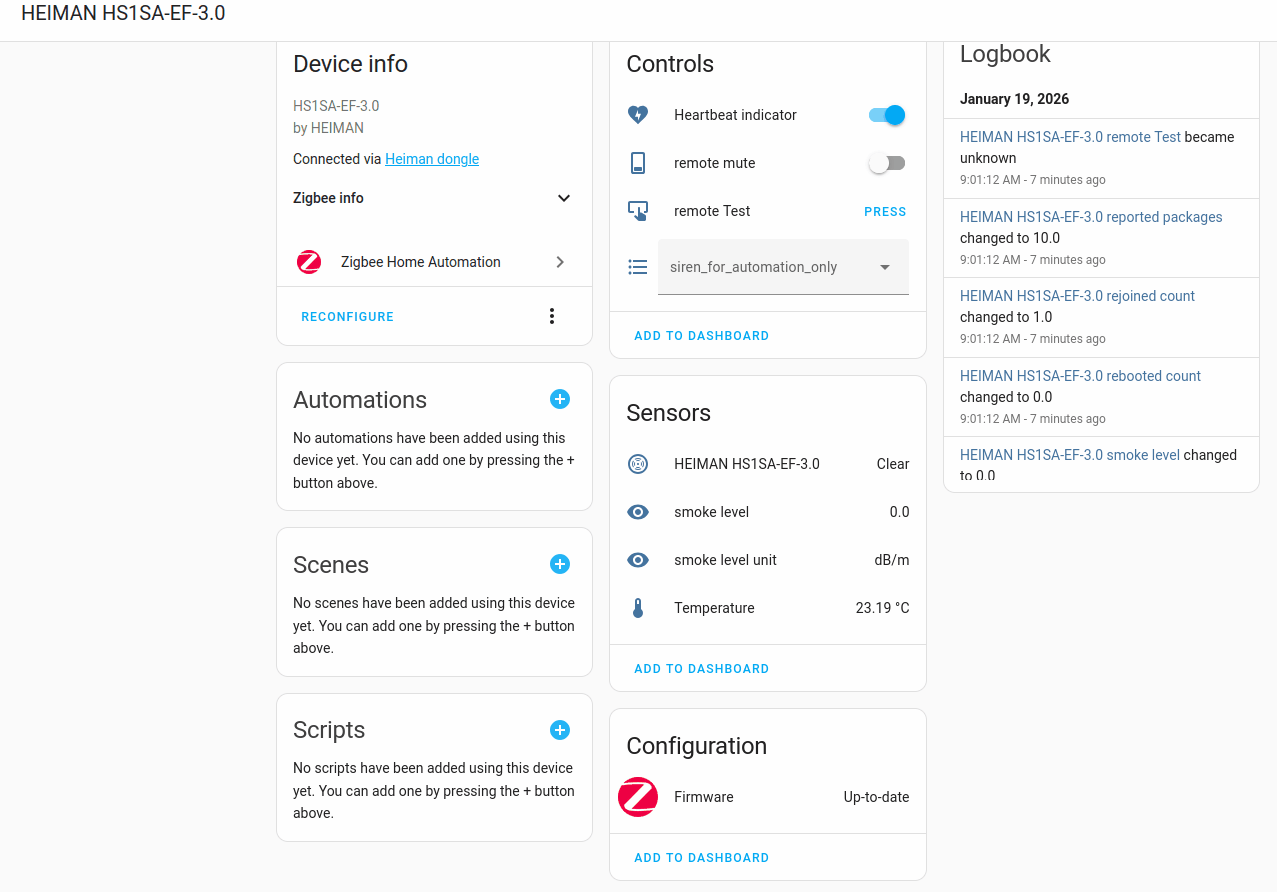

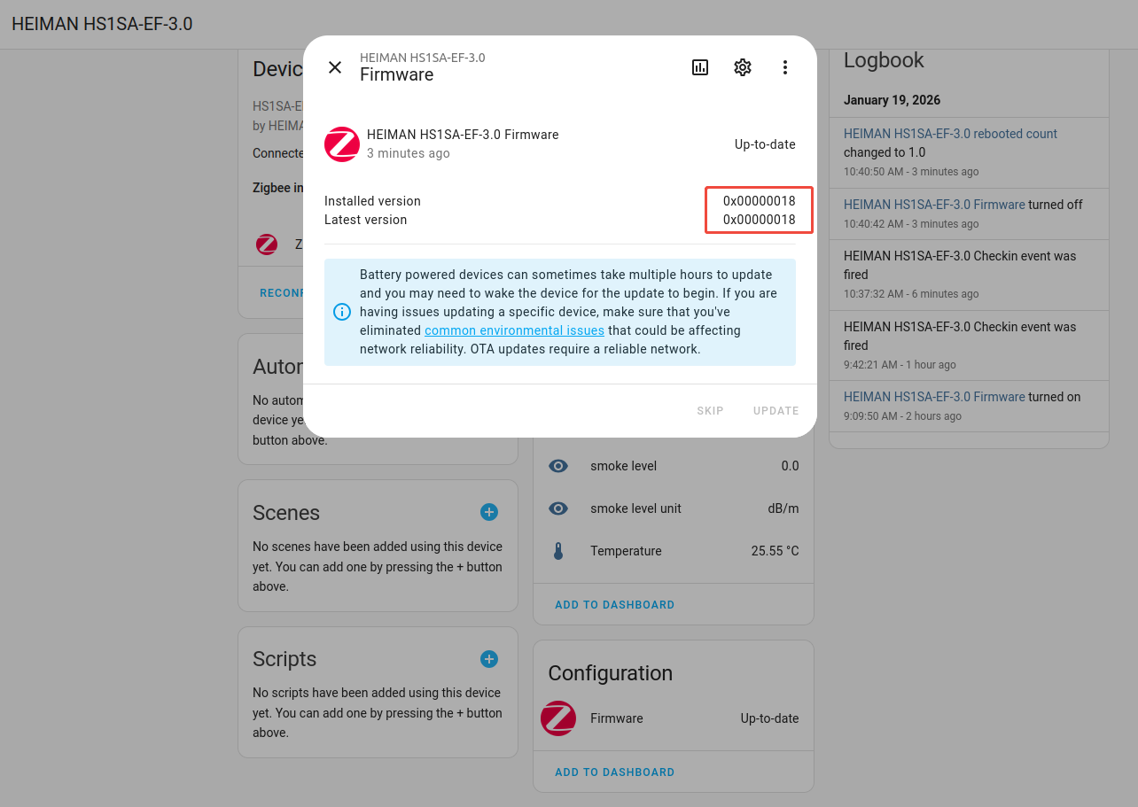

  2. notify the device to check for the update immediately, here is my screenshot of HS1SA-E Plus:
    HS1SA ZHA ota
  3. after 2hour, the device has got updated.

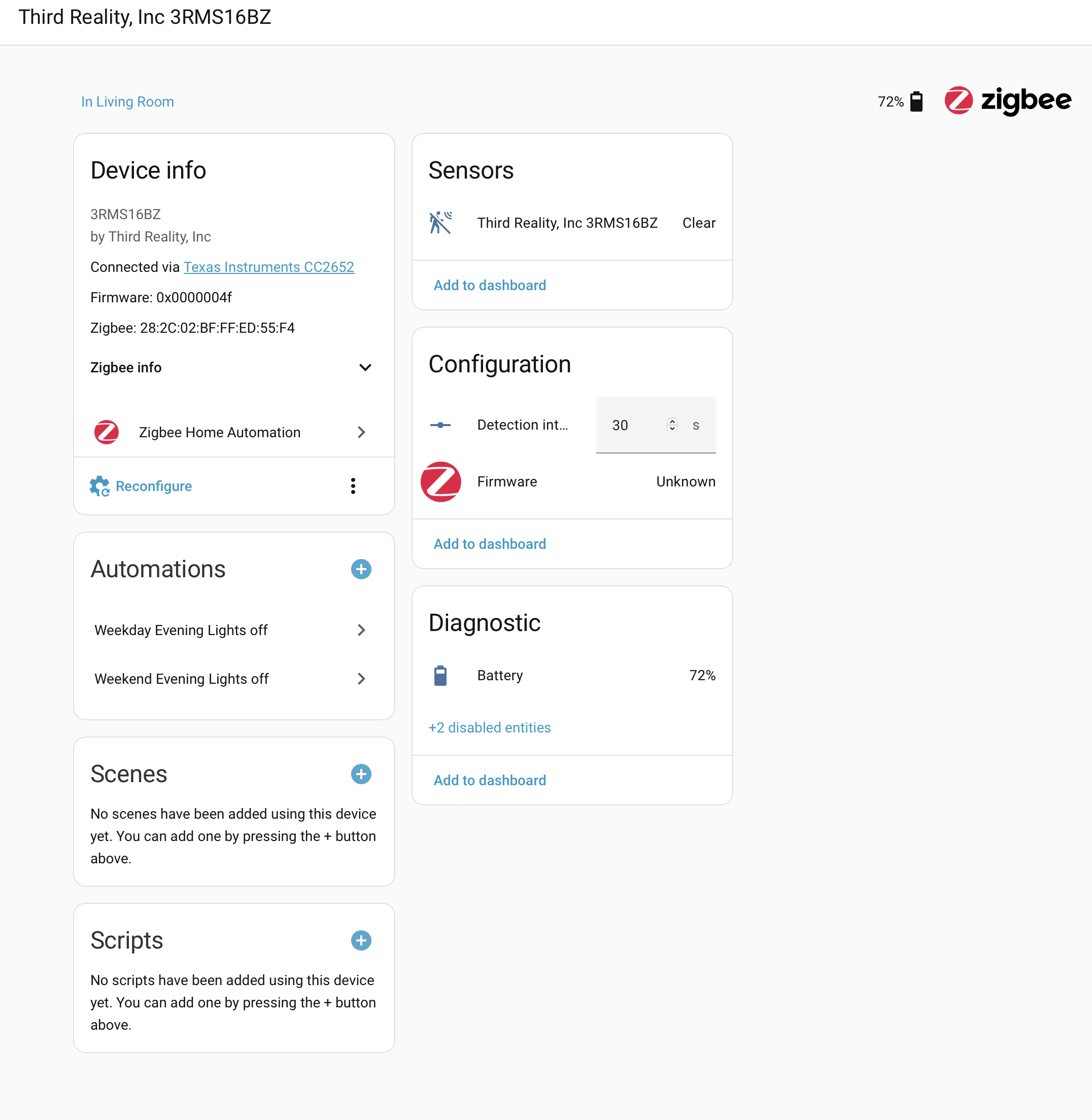

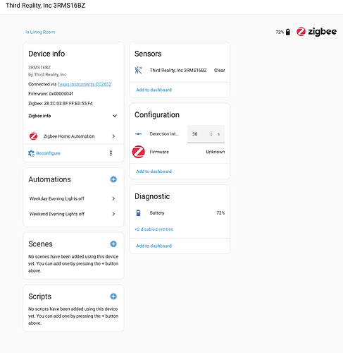

I can’t get this working reliably.
Can anyone tell me why all my devices, including Ikea and 3rdReality, all show ‘unknown’?
Here is my config.yml snippet. I’m currently on 2026.3.0. Maybe I’m too anal about this but coming from a PC world, firmware updates were nearly always important to fix issues.
