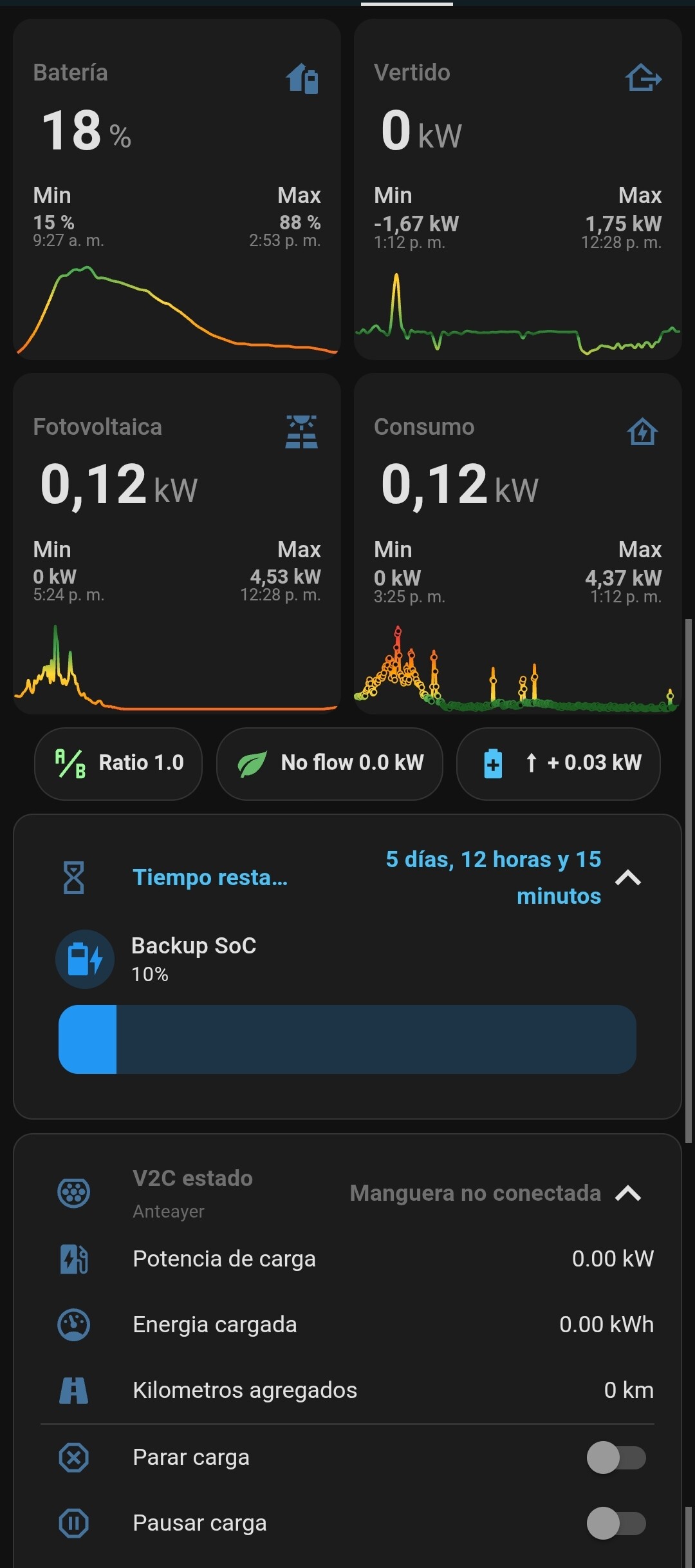

It’s early in the morning and I’m starting to charge the battery, for now the car is not connected, but you get an idea of the setup.
When you get the charger, let us know if you can control it via Home Assistant too!

What I have done is a complex automation to have a better control of the dynamic charge, to use 99.99% as a self consumption:
