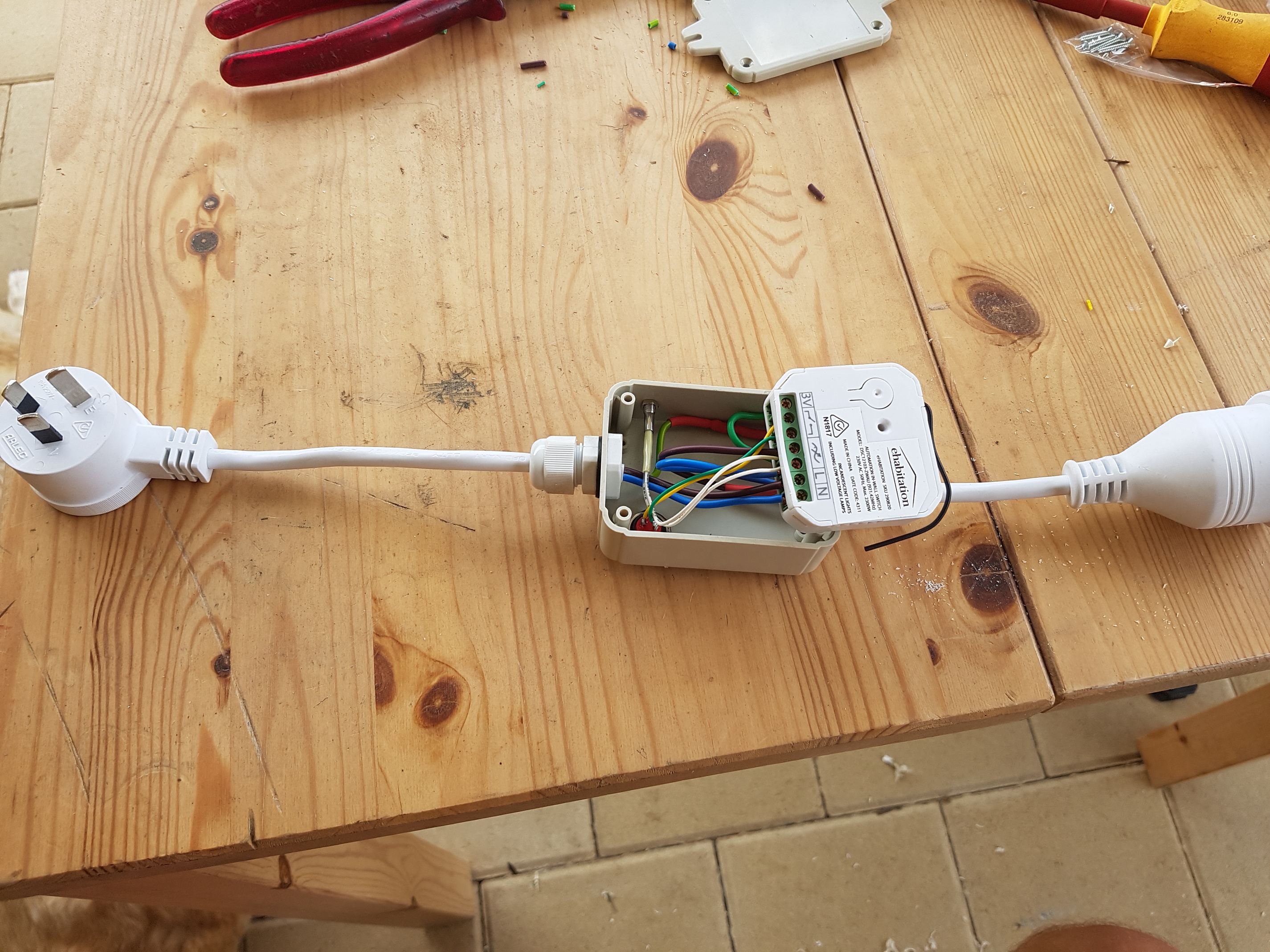

Hi All,
I figured I would show you all how I have made use of some old z-wave switches that I have.
The back story:
I had these hard-wired into my old house which was running a Vera3. Given how unreliable the vera3 was I decided not to leave any of it behind when I sold the house. Now that I am just renting, I cant mess with the house wiring so I figured I would turn the switches into plug-ins!
They are simply hard-wire type switches which I have put into small cases with leads glanded in. There is a switch for manual / local control and a neon to show status.
