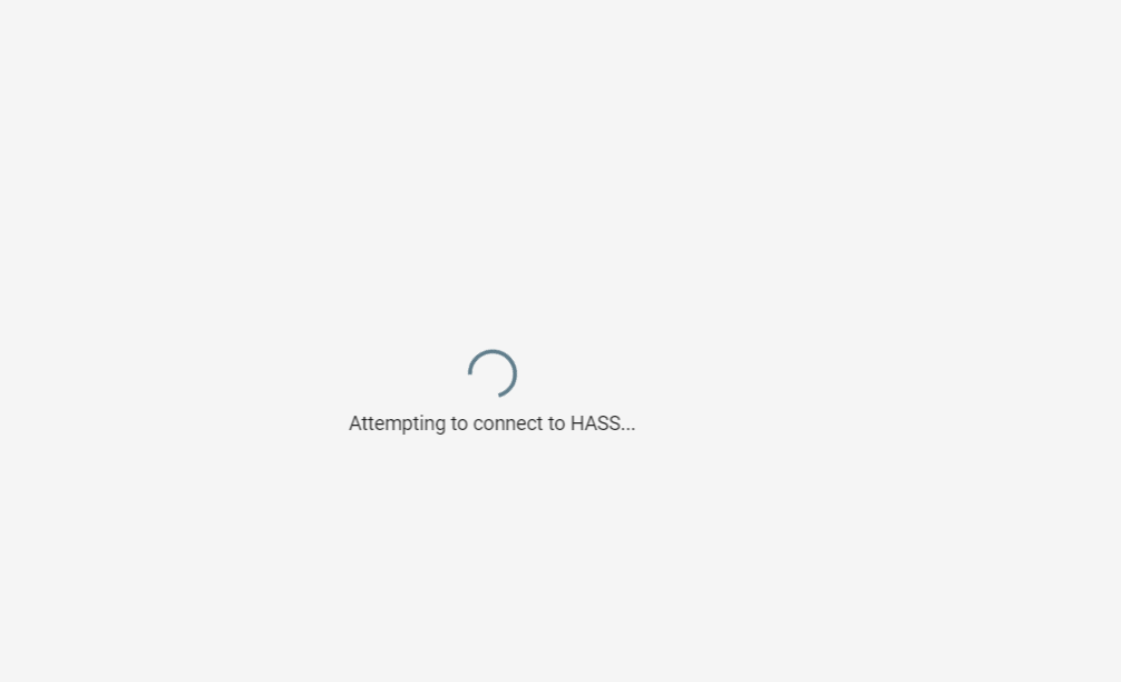

Yes, that is set to false. Here’s the command line I used (well, mostly
sudo docker run -d --name=homepanel -e REACT_APP_HASS_HOST=‘192.168.0.253’ -e REACT_APP_HASS_PASSWORD=/mypassword/ -e REACT_APP_HASS_SSL=‘false’ -e REACT_APP_API_URL=‘http://localhost:3123’ -p 8234:80 -v /config/homepanel/config.json:/usr/src/app/config.json timmo001/home-panel
And here’s the relevant results of a set command in the container
And here’s the console log from Chrome
Connect to wss://192.168.0.253/api/websocket?latest
WebSocket connection to ‘wss://192.168.0.253/api/websocket?latest’ failed: Error in connection establishment: net::ERR_CONNECTION_REFUSED @ haws.es.js:1
Connection failed with code 1
(anonymous) @ Root.js:67

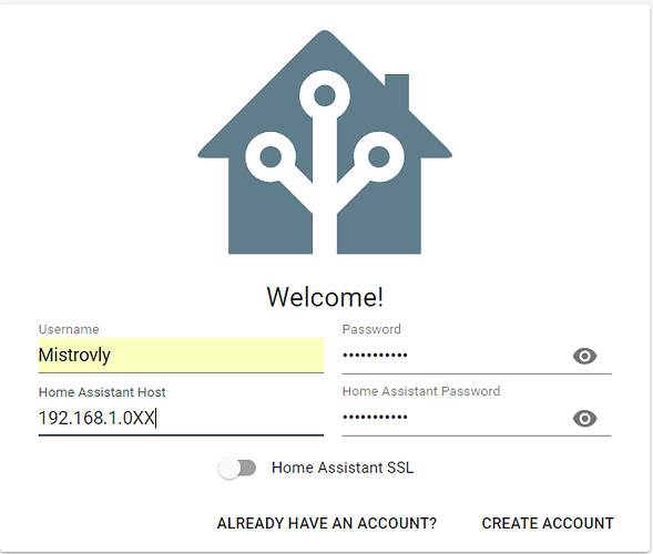

Thank you for sharing this with us and it is very amazing. I’ve been trying to get mine up and running but for some reason i’m having a little issue with the config file. My setup is on docker and when i try to access it, i’ve got this gray page:
Hi @mistrovly,
What do the logs say? If you open up the developer console with F12 on chrome you should see some errors which might help you fix your connection issues
Thank you for taking the time to reply to me.
Actually after a few restart and reinstalling the docker image, i was able to get to the login screen where i can create an account. But when i clicked on create account I got this error
You may have to update the API. Run:
docker pull timmo001/home-panel
docker pull timmo001/home-panel-api
then run the containers again and see if this fixes your issue. This looks like a CORS issue which should have been fixed in v0.2.1 of the api
thank you for the fast reply. unfortunately that did not fix it. also when i ran the first command it’s telling me that is already up-to-date and i did pull a new version of the API.
Try running the containers again, then clear the cache/cookies in your browser. Hopefully this fixes it.
