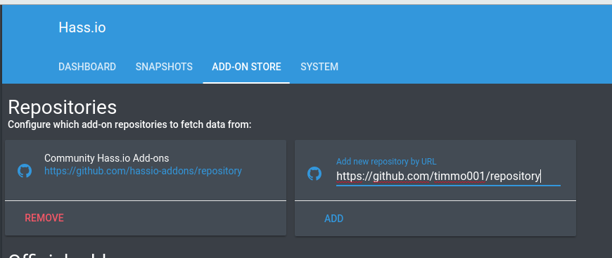

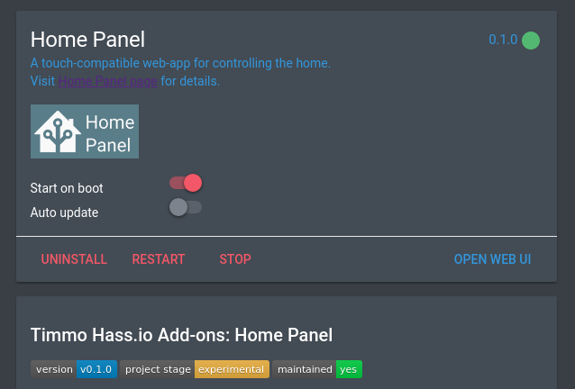

Hassio Add-on Released! :tada:
After many days of fixing, updating, documenting and fighting with build servers, I am finally happy to announce the Hassio add-on is ready for public consumption!
Just paste this URL into the add-on store: https://github.com/timmo001/repository
click add, then scroll down and install Home Panel in one click!
You can then edit the config file at /config/home-panel-config.json (by default) using the docs.
For documentation on the addon see:
https://github.com/timmo001/addon-home-panel
