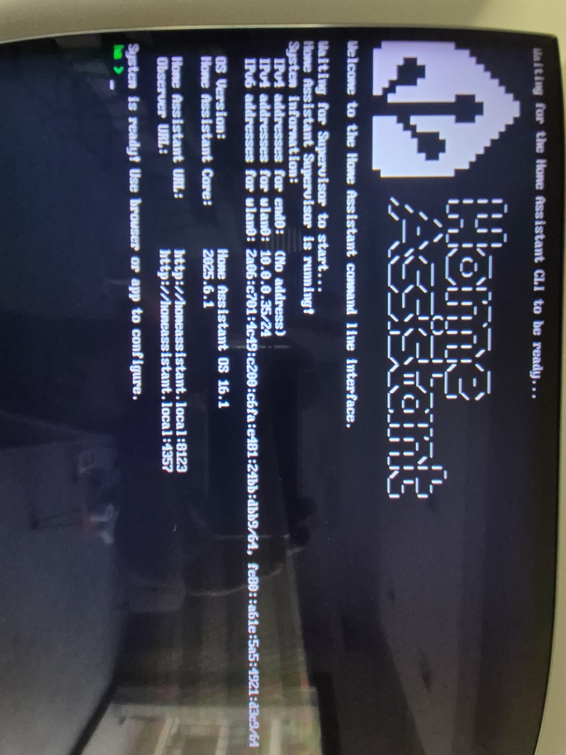

It says it has the IP address 10.0.0.35. Is that in the address range your local network uses?

This is after I tried to set up wifi again. Ping to 1.1.1.1 no response same for 8.8.8.8 or google. Can’t connect through cable. Wifi should be good enough. Worked months without issues. Now I can’t get it to work properly again. This is the core. An automation platform without proper network connectivity is useless. This has to be fully transparent. Ask for wifi network that’s it. Instead of investing in unneeded UI features, fix this.

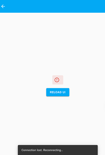

After fighting with it for 3 hours, adding DNS, restarting network and doing all kinds of voodoo, I can connect now but it so slow and quirky, it’s not really usable. I cannot update anything. It keeps reconnecting and fails in simple operations like showing logs. So bad.
