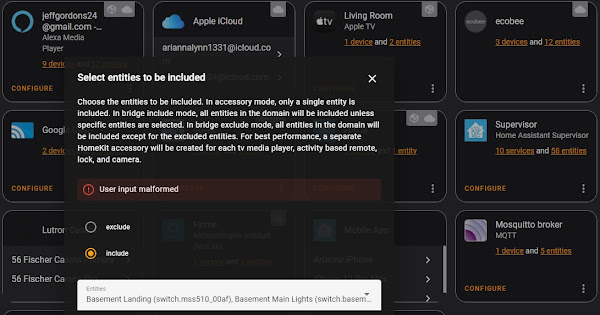

HomeKit error "User input malformed"

I had the same issue, if you load up your core config in the .storage folder you will see the “hass bridge” listed followed by the “included entites”
What I did to resolve was go through that list and find the entity that is no longer in the HA config. I then renamed an entity with that name and was able to save the HASS config without issue, then I looked for that entity in the GUI and disabled it. After that I just changed the name of the entity back and all was good, no more errors.

If you trace back and figure out what entity ID has changed and left a ghost entity in you HASS Bridge config you should be able to revert or even change one of your other entity id’s temporarily to match so you can reverse the issue.
