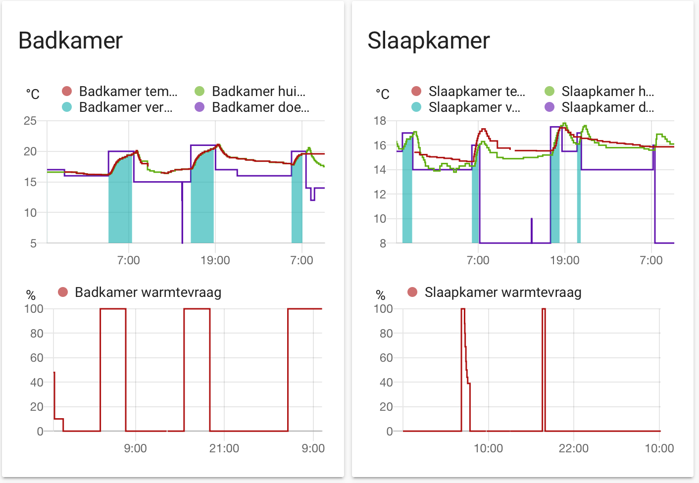

In your graphs, I plan for the shaded area (call for heat) in the official evohome integration to be removed unless I can find a way to make it more accurate.
The temps are a long story - HA’s official (RESTful) component shows the zone temps, the RF custom component shows device temps - these do not have to match. Specifically, only one of the devices in a zone is used for the zone temperature.
The new code will tell you which of these devices it is, for example, have a look at zone 1 (‘Front Room’) - notice zone 0 is missing a sensor (it is the controller):
