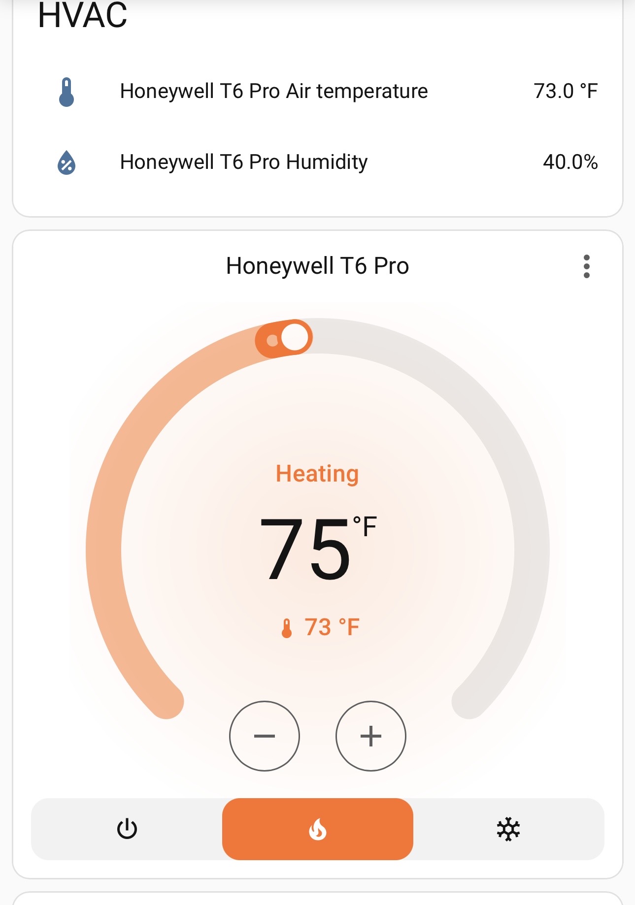

UPDATE: Wait a minute. This is reporting command class 66. Shouldn’t that be command class 64?
That is,
  1. the T6’s mode was manually updated on the thermostat
  2. the T6 sent the update to z-wave-js
  3. z-wave js sent and the integration received the state change over the websocket.

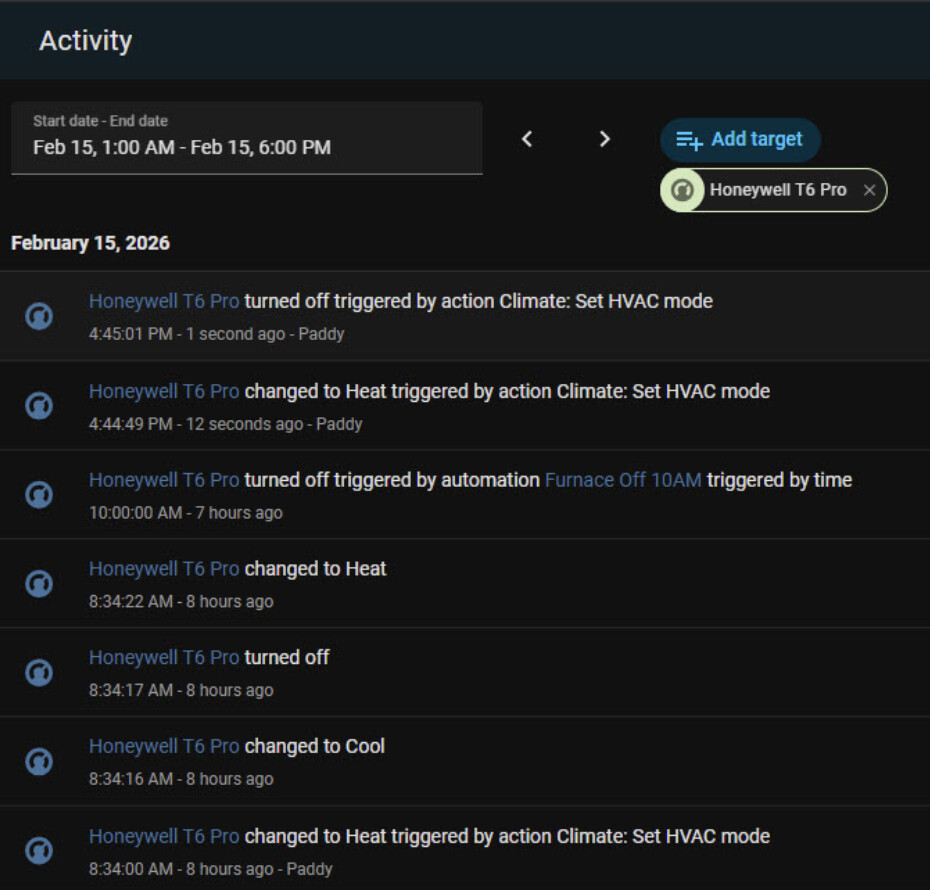

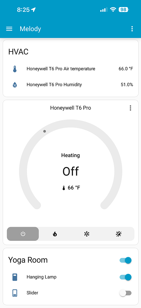

But the Entity still shows off:
And if you look at the Activity for that entity there’s no state change to “Heating” around 3:07pm:
The state change at 4:44:49pm was done by updating the mode on Home Assistant.
Doesn’t it look like the z-wave integration received the state change but for some reason the entity’s state didn’t get updated (and didn’t update the states table in the DB, either)?
@Paddy707, is that all accurate?
Is there a situation where the integraton would log the state change but not update the entity?
The log message shows the operating state changing, not the mode. The operating state is the climate entity’s hvac_action attribute.

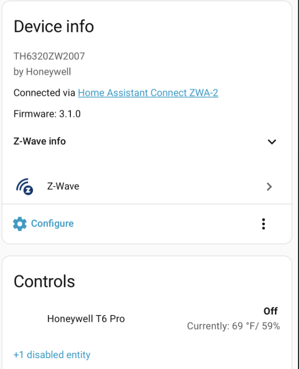

@Paddy707 Are you pressing this mode button?

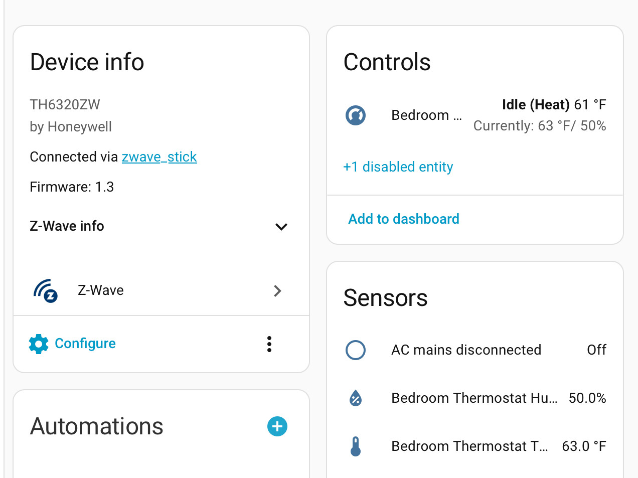

What firmware version do you have? Mine is 3.10
I have 3.0.2.
Thanks! I am wondering what @PeteRage is using too.
Version 1.3
Do you mean 3.1? Do you have the 2007 version?
1.3
They both have the same prefix but one is a 2003 and the newer one is a 2007. Based upon your firmware, I’d guess it’s a 2003.
If it helps I have the 2007 version with FW 3.0.2 and I’m pretty sure mine is working
When I hit the mode button from the thermostat itself and switch between off and cool it’s reflected in the HA state for the climate entity.
Ok. Thanks!

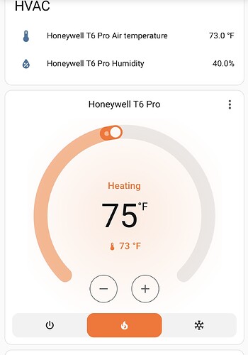

Does this update the mode? As I have mentioned, mine says Heating/Off and it should be Heating with the red fire icon.

But, I do find this odd from your image above:
I cannot make my thermostat in HA display the mode Off and yet Heating at the same time. For example, I turned on the heat and it said Heating and was red, then manually set the T6’s state in Developer Tools to off and it goes to Idle.
Maybe the operating mode (hvac_action) isn’t getting updated? Once again, it’s the z-wave and HA logs that will tell you if the T6 is sending the expected state changes. Then you watch Developer Tools to see if the entity reflects those states. Otherwise, it’s just guessing.
It kind of seems like updates from the T6 are not making it to HA. Again, the logs would show that.

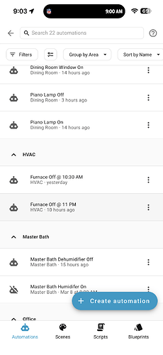

Why are you turning the T6 off twice a day?
Not to be “Doctor, it hurts when I do this thing.” but maybe don’t turn it off so that you don’t have to figure out why it’s not turning back on? Just lower the temp.
