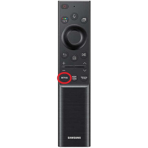

I would like to know what command to send to simulate the Netflix button on this remote control through call service “remote.send_command”:
