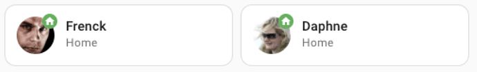

How do I add a status to person icon?
I keep seeing this but don’t see where to do it, or with which card. In the screen shot you see a little house. Seems like it should be there somewhere but I can’t find it. I assume I could assign a number of icons based on location?

It’s the Tile card.
Just select a person entity, the badge icon will be set according to zones and home/not_home state.
Means, not only home/away but individual icons for every location?
Create more zones and assign icons to them. When my wife goes to her friend’s house, she gets a cocktail glass icon :slight_smile:
