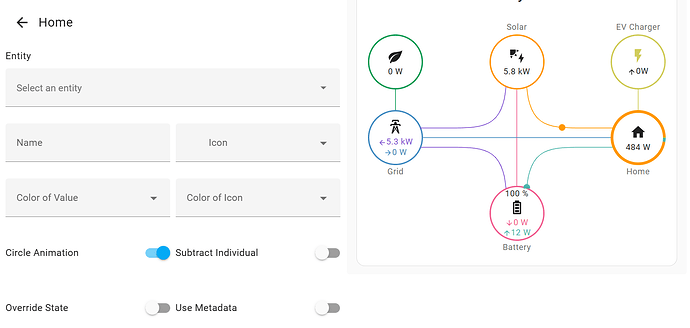

Good bit of info, however, wanted to understand what entities people have under “Home”. Currently I have nothing listed in the Home Entity … but as you can see the home symbol still appears … am I supposed to have something in there?
Ah, I see. I don’t have anything set up there either. I guess if you have a sensor that reports your energy usage you can put it in there, otherwise it’s calculated.
