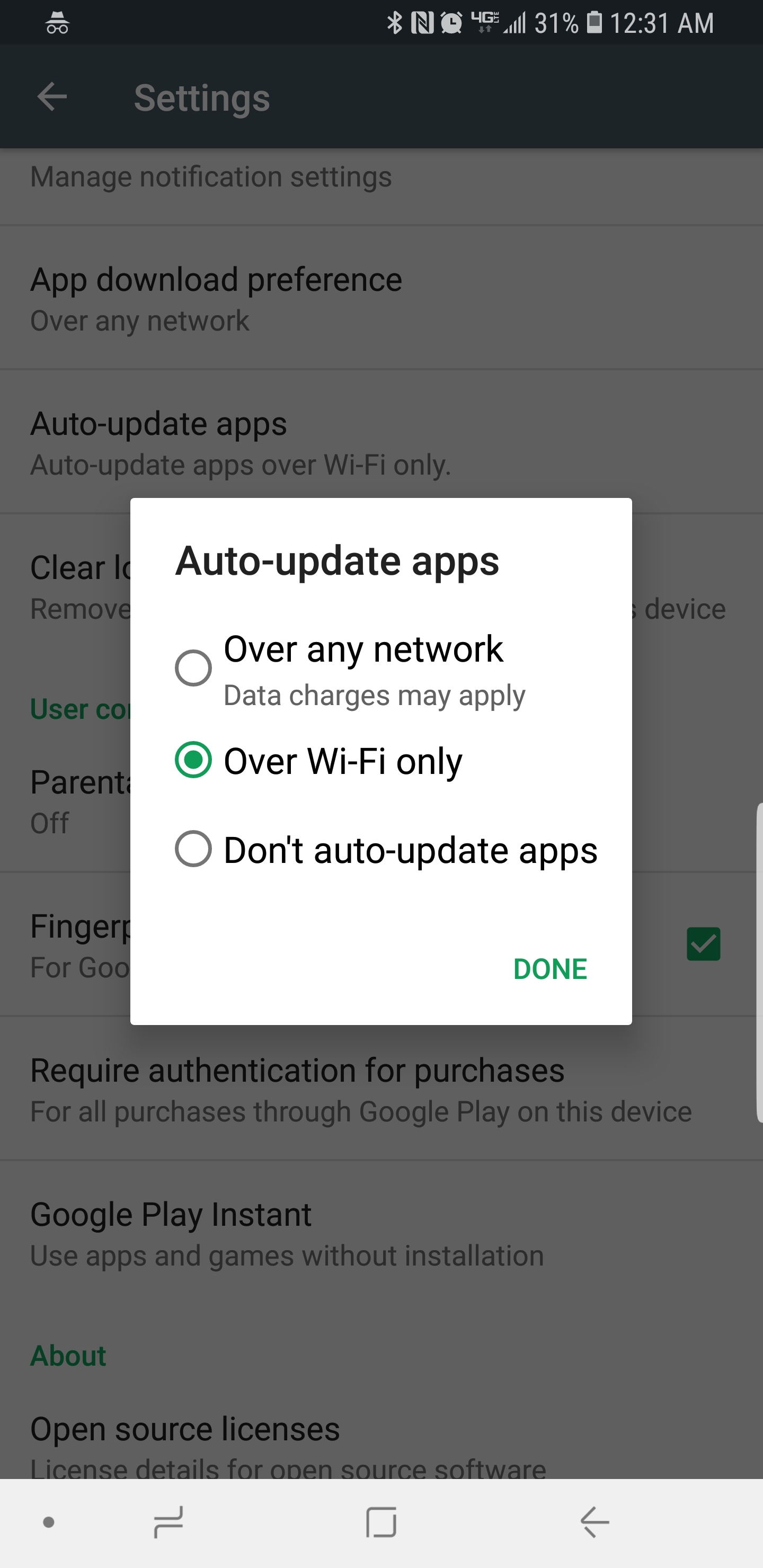

Regarding stopping the updates, I’m not sure about the OS, but in google play you can turn off auto-update in the settings.
For the OS, maybe see what URL it fetches the update from and block that URL in the parental settings in your router.
