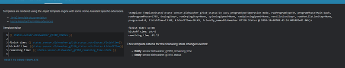

Hey all,
need some help with time please.
im trying to work out the “total time” (so end - start)
however I keep getting an error when i try and subtract the values?
maybe because the “time” is only in “hours:min”?
{{ states.sensor.dishwasher_g7310_status }}
finish time: {{ states.sensor.dishwasher_g7310_status.attributes.finishTime}}
kickoff time: {{states.sensor.dishwasher_g7310_status.attributes.kickoffTime}}
remaining time: {{ states.sensor.dishwasher_g7310_remaining_time.state }}
results:
<template TemplateState(<state sensor.dishwasher_g7310_status=In use; programType=Operation mode, rawProgramType=0, programPhase=Main Wash, rawProgramPhase=1795, dryingStep=, rawDryingStep=None, spinningSpeed=None, rawSpinningSpeed=None, ventilationStep=, rawVentilationStep=None, progress=0.0, finishTime=13:08, kickoffTime=10:49, friendly_name=Dishwasher G7310 Status @ 2020-10-08T09:43:16.002482+01:00>)>
finish time: 13:08
kickoff time: 10:49
remaining time: 02:19
You need to convert the time to “timestamp” first and do your calculation. You can convert the result back to hours and minutes.
{{ ( as_timestamp (states.sensor.dishwasher_g7310_status.attributes.finishTime)  | int ) }}
hey,
thats giving me “0” im afraid.
