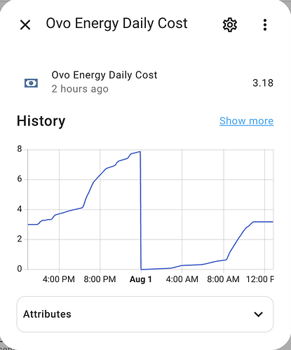

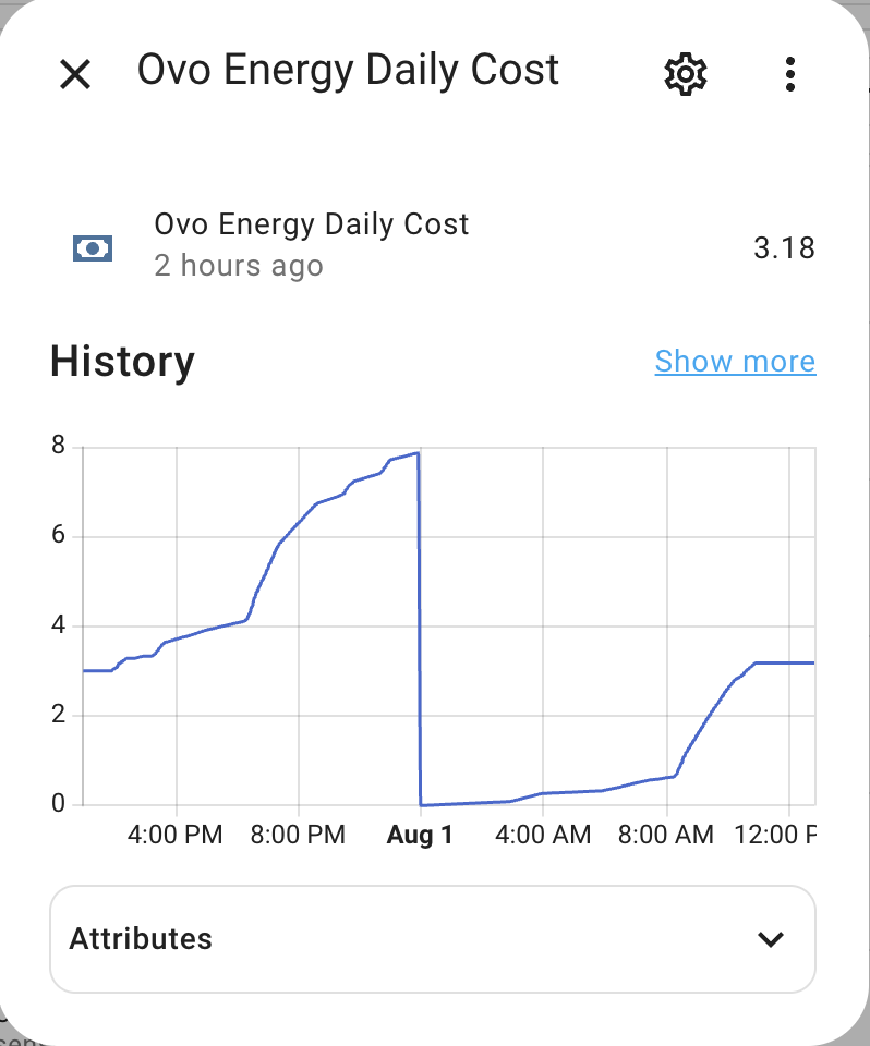

  1. Last is to use utility meters for daily, month, yearly costs. These are simply utility meters using hourly cost, set to reset a day, month, year.
Happy to help further if you need. As per above, now I have reviewed my setup, the current rate is not used in the calculations but I think I had it for an earlier method before I settled on having the main utility meter reset hourly and then calculating hourly costs.

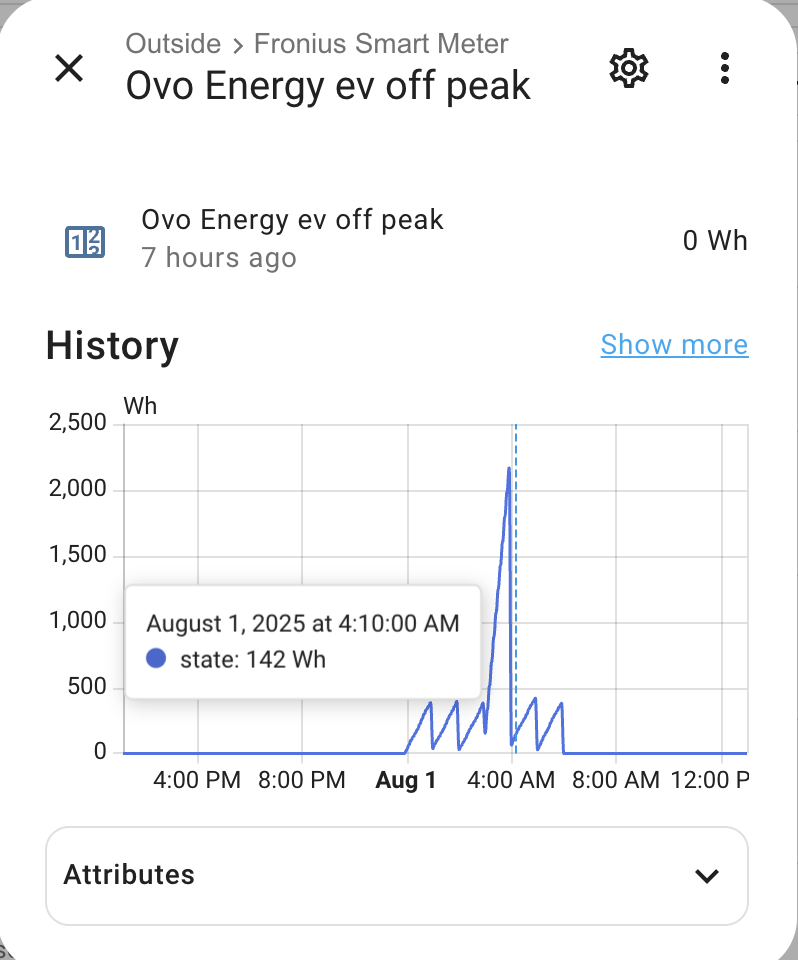

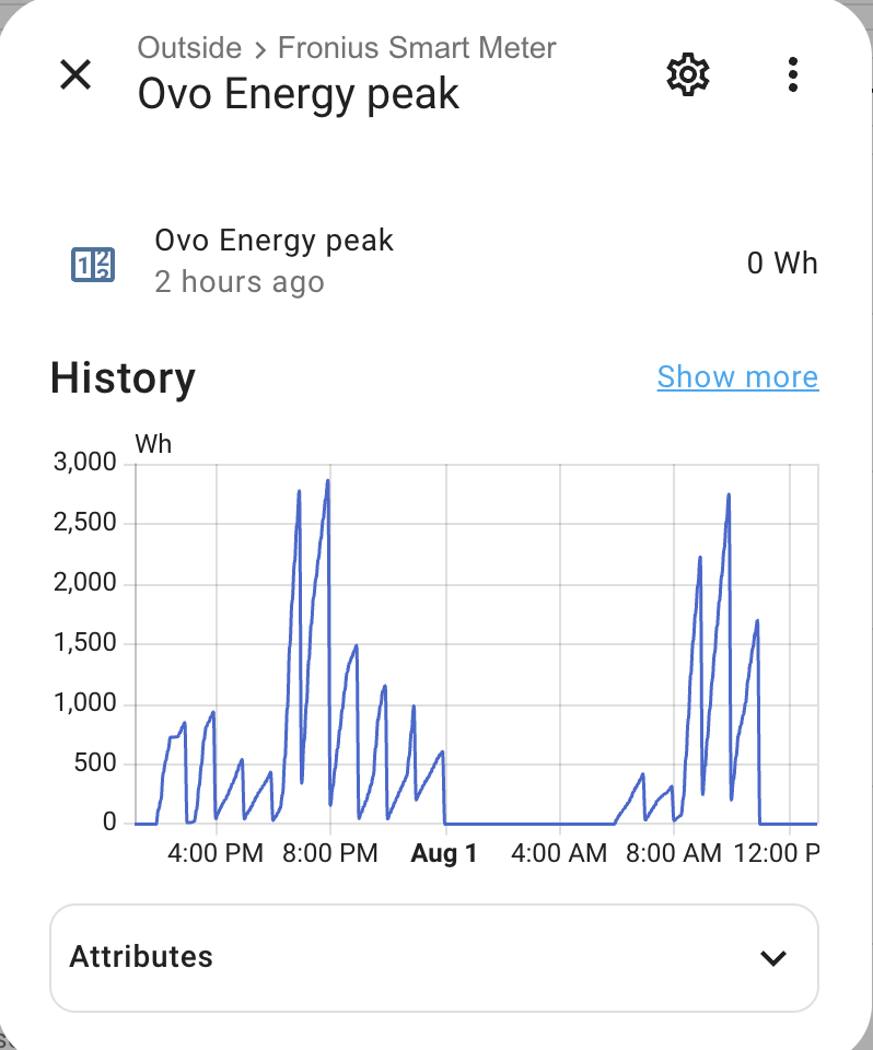

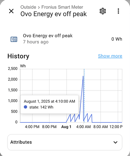

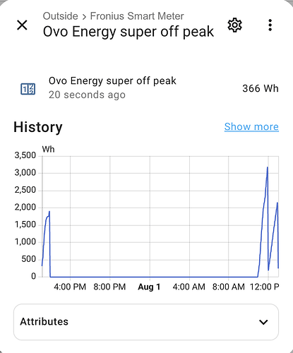

For interest, my current daily cost for last 24 hours. Very cold days here in Sydney so a bit of AC in morning and evening. Mid early morning bump (3am) is a boost to hot water heat pump before morning. It then turns off and does its main heat at 11am on 3 hours of free power.
Also, the sub utility meters showing how they track consumption.
