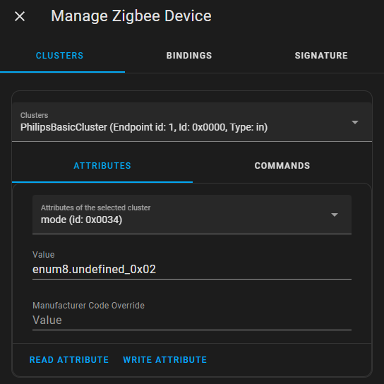

OK, here’s the meat of the meat and potatoes:
Hue wall modules ship by default prepared to handle a single rocker. Momentary switches, when connected to the Hue module, generate two “left button pressed” events instead of one. This is obviously bad because now you need to add debouncing to your automations.
What you must configure is the ZigBee attribute mode (0x0034 or #52 in base ten) of the PhilipsBasicCluster cluster. For a single push button, the mode should be 1. For two push buttons connected to the module, the mode should be 3. Go to your ZHA device clusters page and set the attribute there. You may have to push the wall switch button right before you click on Set ZigBee attribute, otherwise your Hue module will be asleep and ignore the command.

I don‘t know what I‘m doing wrong - but I can‘t overwrite the value.
I see
enum8.undefined_0x00
But can’t change it to 2
Erase the value in the textbox and change it to 2.
Can’t do it? Please post a screenshot.
While i get a success notification the value stay the same

nevermind, it actually worked if you replace it with “2” not just the last character.
You just have to type 2. No need for the enum undefined junk.

The improve your blog post, please show a screenshot without “enum.undefined…” when changing the mode. Else it does not work when writing the updated mode.
