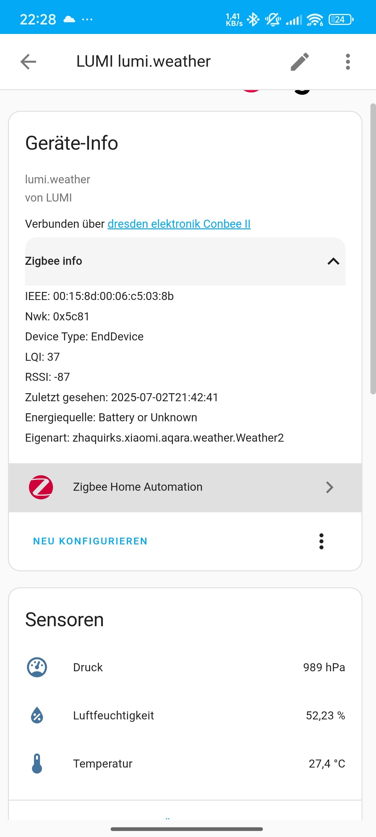

I have exactly the same problem with one sensor! I have 4 of these sensors and one is only reporting pressure and unknown for temp and humidity!
Did you find a solution?
For comparison, another sensor that is working:
I haven’t found a “solution” – but as of now I assume that the sensor is simply defective.:man_shrugging:t2:
